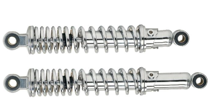

Increase ride height, definitely. Longer travel to absorb bumps and thumps, not guaranteed as you aptly said.
For example, these 2 shocks will have the same performance when it comes to absorbing bumps and thumps:
