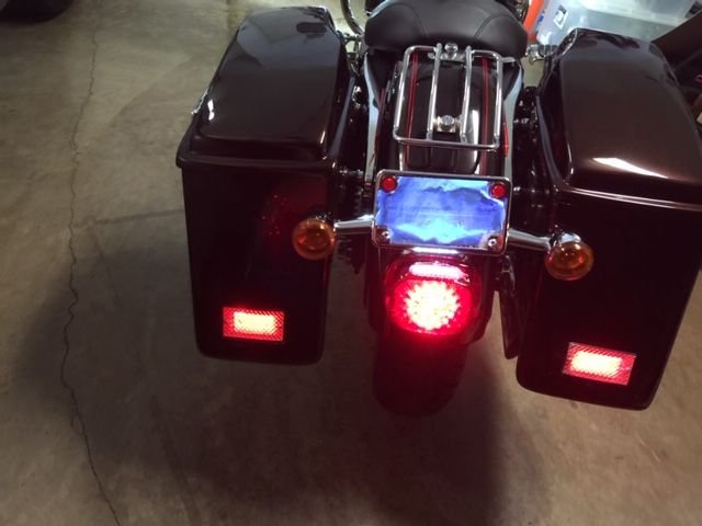

Here are my rear running lights...my bags have a run/brake/turn module. Stock turn signals not on.
I even had an aftermarket integrated tail light with turn signals and it did not illuminate as running lights.
