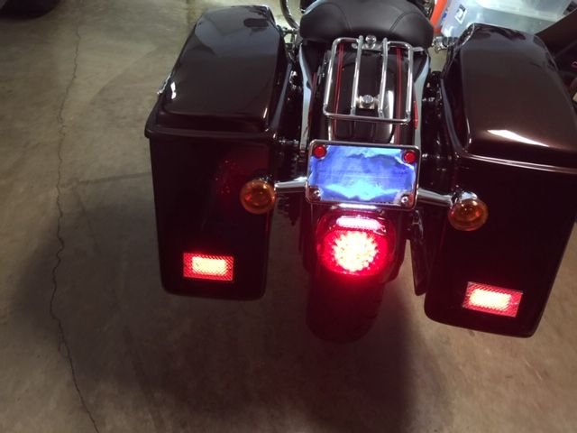

HD quick release sissy with aftermarket quick release hard saddlebags

Wow thanks. Any chance of a closeup of the mounts, as pictured?

I just used the HD quick-release mounts between the saddle bag mounts and struts. I had a sissy and luggage rack (not the one on bike) that utilized the mounts.
Depending on which way your bags open, be sure there is enough space between the struts and bags so the lids are able to open.
HD sissy and HD luggage rack with quick release mounts.

My bags were mounted to the same bolt as the HD quick release docking hardware. Here is a pic of the HD docking hardware that looks like the type used for my applicattion. https://www.harley-davidson.com/stor...01-5396406b--1
If you viewed the Tsukayu video on the installation of the mounts, the docking hardware went between the bag mounts and the struts....I just used slightly longer bolts. The bags did not require bottom support brackets.
BUT keep in mind the further out you go i.e. the longer the bolt, the less stable the bags will be.....which is why I made it so when the sissy or luggage rack were mounted, the bags could not be opened. I needed to remove the sissy/rack if I wanted to get in the bag....a little inconvenient but outweighed the versatility I wanted....which is why I normally use a fender mounted luggage rack (in pic above) and not the HD rack when bags were on. Normally used the HD rack and sissy without bags.
