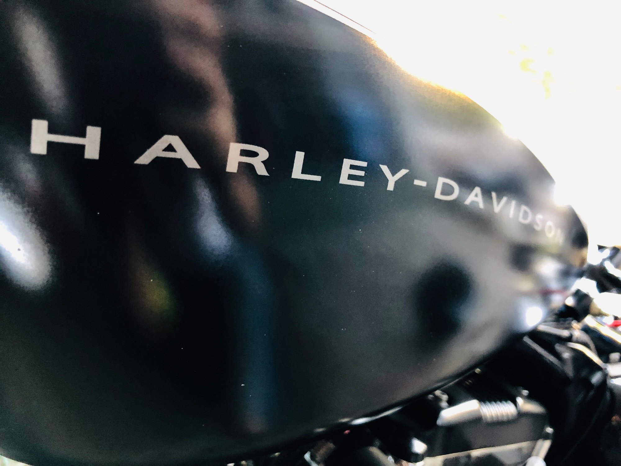

Congrats on the new bike OP, and enjoy the customization process. Consider giving the existing tins some tlc before painting, they can look pretty outstanding.

How you get the paint to look that good? Looks great!

How did you get your paint to look that good johnny_bravo00?

Just your basic garage stuff. Claybar, polishing compound, wax & some elbow grease.
