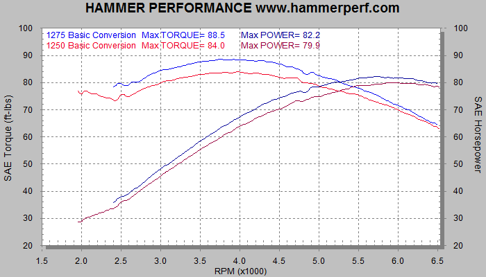

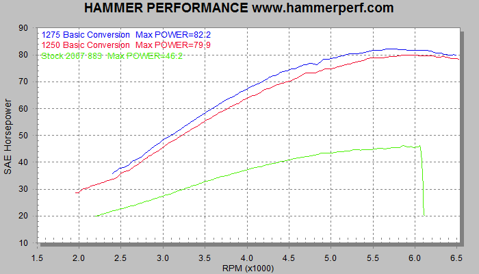

Heres a Hammer basic conversion with stock cams and heads.

That's a matter of opinion. Fact is the stock exhaust is extremely restrictive and not conducive to any kind of performance. It's half the problem of his poor dyno result.
Khromewerks makes a great slip on that's not obnoxiously, tinny loud and has great low and midrange torque without being resrictive. 88ft.lbs. on my 1250 @4500rpm.
Rush makes a good slip on too.
Hammer has dynos of all sorts of different exhausts. The stock exhaust gives up as much as 24HP in some cases.

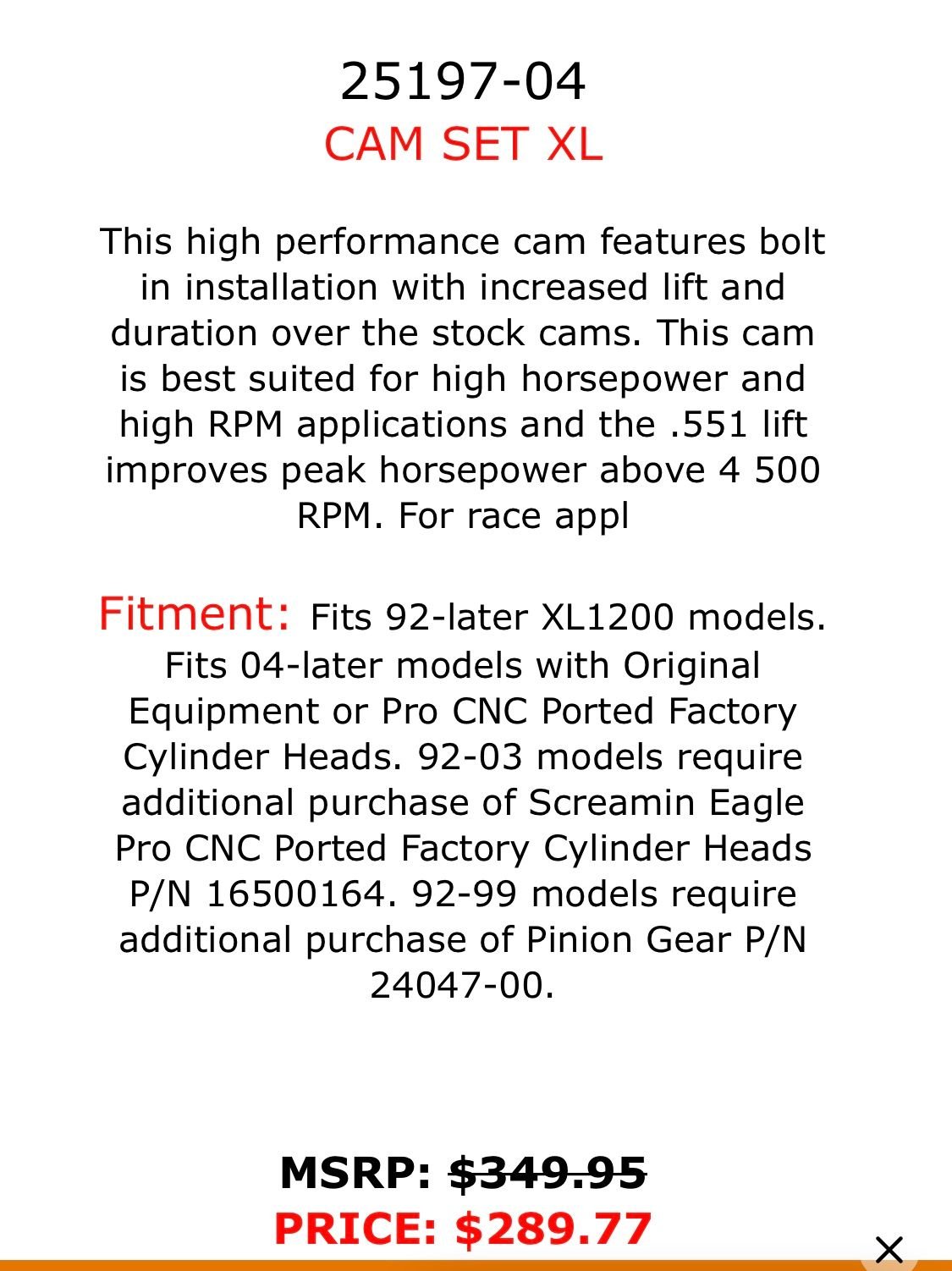

That says 1200s.
For high hp race applications? That's a stretch. Pretty mild for what the lift suggests. But what do you expect from a dealer.

The cams they put in were part no. 25197-04
