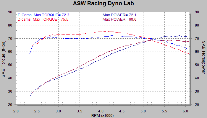

Here's a test from many moons ago:
Caveat: the 536 cams will not work with stock 883 heads of any year, where the E cams will work with stock 2004+ 883 heads (but not earlier 883 heads).
Here's another piece of data that's perhaps more relevant:
"D" cams were original in all 1991-2006 XL883's and 91-03 XL1200's, except the 98-03 1200S model, which had "W" cams.
So as you can see, in this test the E cams costed some power below 5000rpm and gained some power above 5000rpm.
Both of the above results were 10:1 motors. 10:1 is a little low for the SE 536 cams though.

Let me ask you this ... looking at that second dyno sheet I posted, and considering your statement that you'll "probably never exceed 4500 rpm", which cam set would you rather have, the D's or the E's?
Here's another snippet of data for you ...
Keep in mind that your factory original cams were W's. Notice how they beat the D's across the entire rpm range.
