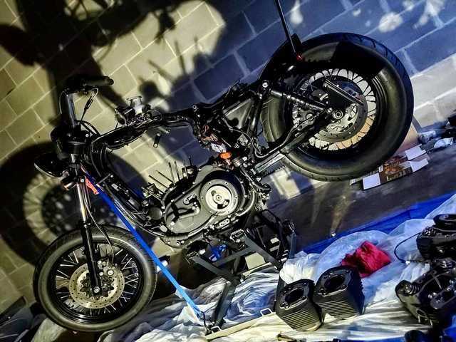

Well I decided on making a build thread over here on HD forums. Haven’t been on this site in a while, been hanging out over on XL forums.
i finally got the time to knock out a 883 to 1275 conversion. I’m going with Hammer Performance. I’ve been wanting to do this for a few years now. I decided on going with the 90ish HP setup which includes 1275, impact 560 cams, and some head work.
Here she is before I tore her down. Was originally a ‘12 Iron 883 I bought new. I’ve done a
lot of work over the years, very happy with the way she sits now.
But definitely needed an improvement in the engine!

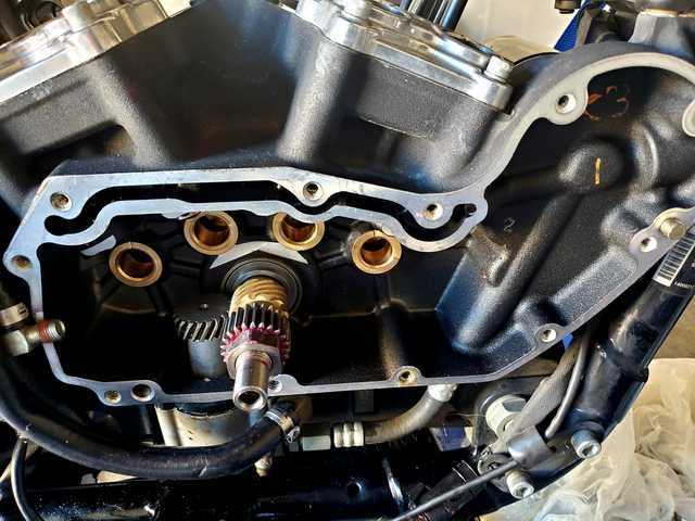

Engine torn down and heads sent off to Hammer for some work.

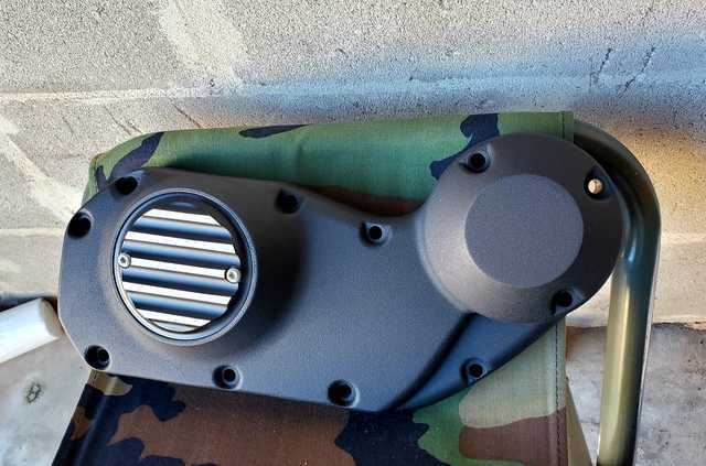

Chopped the cam cover while I had it off for the cam install and bronze oil drive gear install. Still need to wet sand edges and either powder coat or just spray with HD wrinkle black paint.

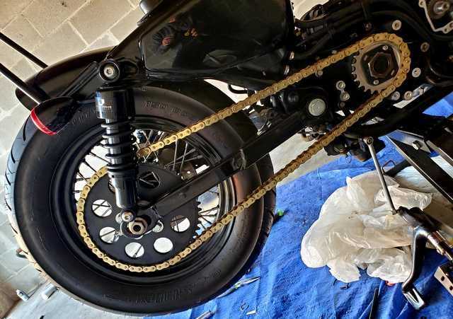

I forgot to order the bronze oil gear drive so I gotta wait on that so I can install cams. Also doing a lowbrow customs belt to chain conversion. Need to find a 1 7/8 socket for the sprocket tho. I also dropped off the tank for some new paint and need to figure out a new exhaust too.

"Need to find a 1 7/8 socket for the sprocket tho."
This might help.
https://www.883sportster.com/product...ey-tools--Kits
Old Dec 22, 2019 | 11:39 PM
Bryan83taco's Avatar
Bryan83taco
Joined: Apr 2012
Posts: 444
Likes: 138
From: Hawaii
This might help.
Thanks, I had to order one off Amazon. Only local socket I could find was an hour away. Not worth a two hour drive when I can order off Amazon prime!

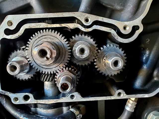

Back from holiday vacation. Got the bronze pinion oil gear installed then got the cams lined up. Let me know if you see something wrong with my timing!
This damn transmission sprocket is giving me a hell time. Been using heat, 25” breaker bar, PB, and now an impact. And yes I know they are reverse threaded.

Got it. I needed a big *** cheater bar. Really happy with the way the chain conversion came out.
Finished up the cam cover too, also happy with the results

Did you powder coat them yourself?
