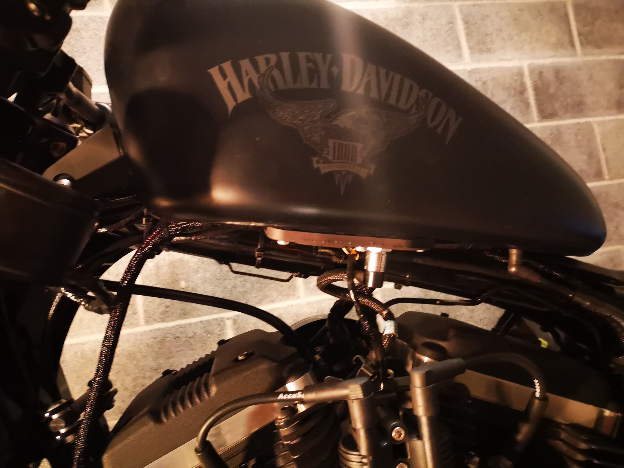

- 1.5 inch tank lift and wire tuck.

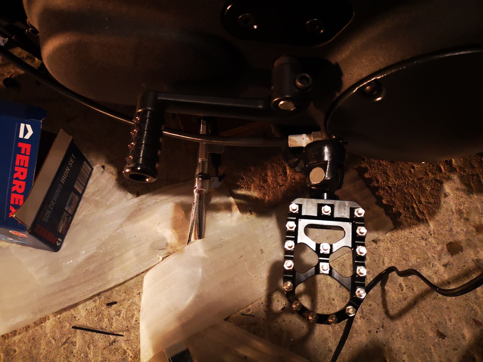

- Mx style foot pegs
- joker machine shift peg

Here's the tank lift.

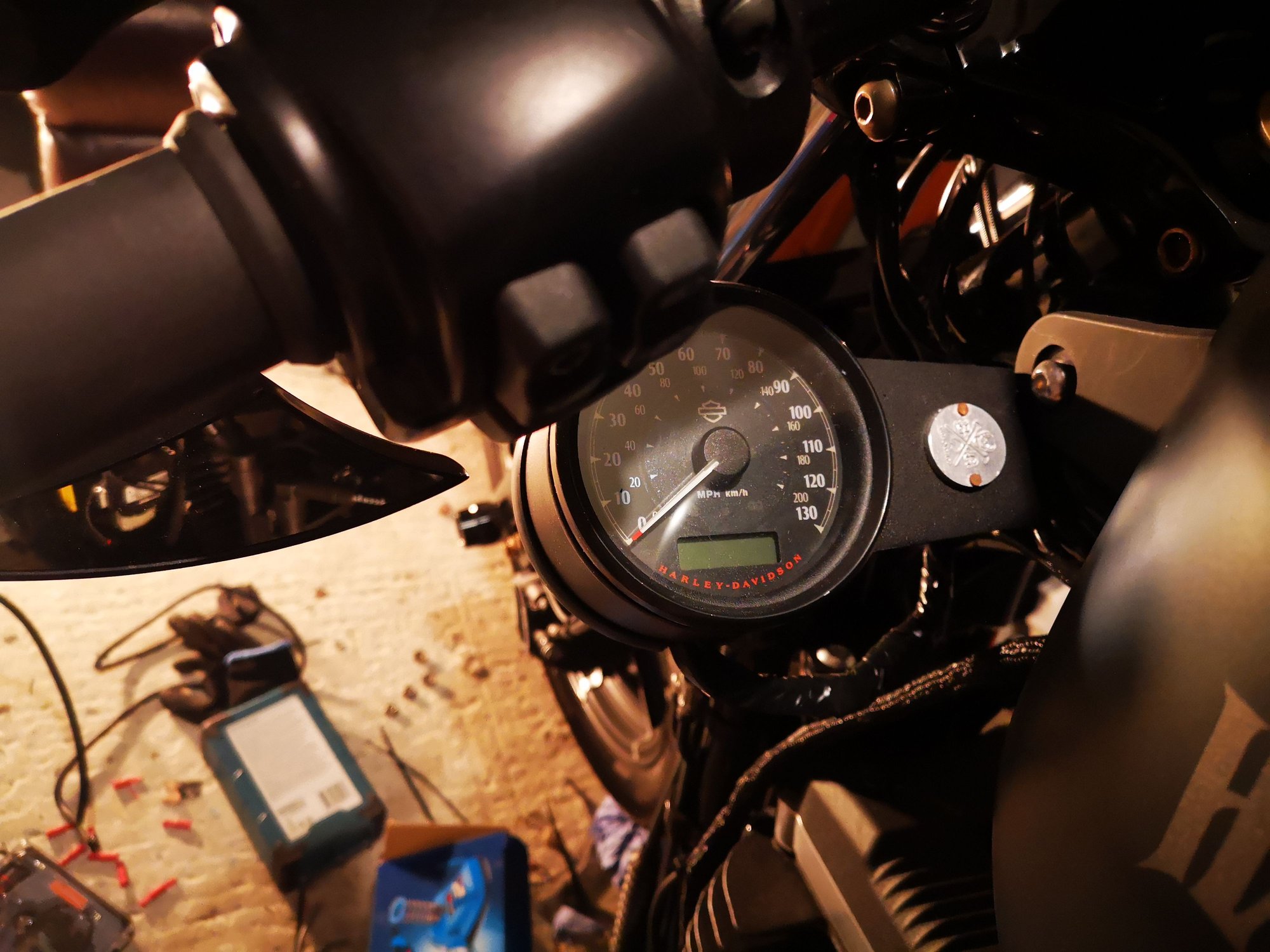

Speedo relocation

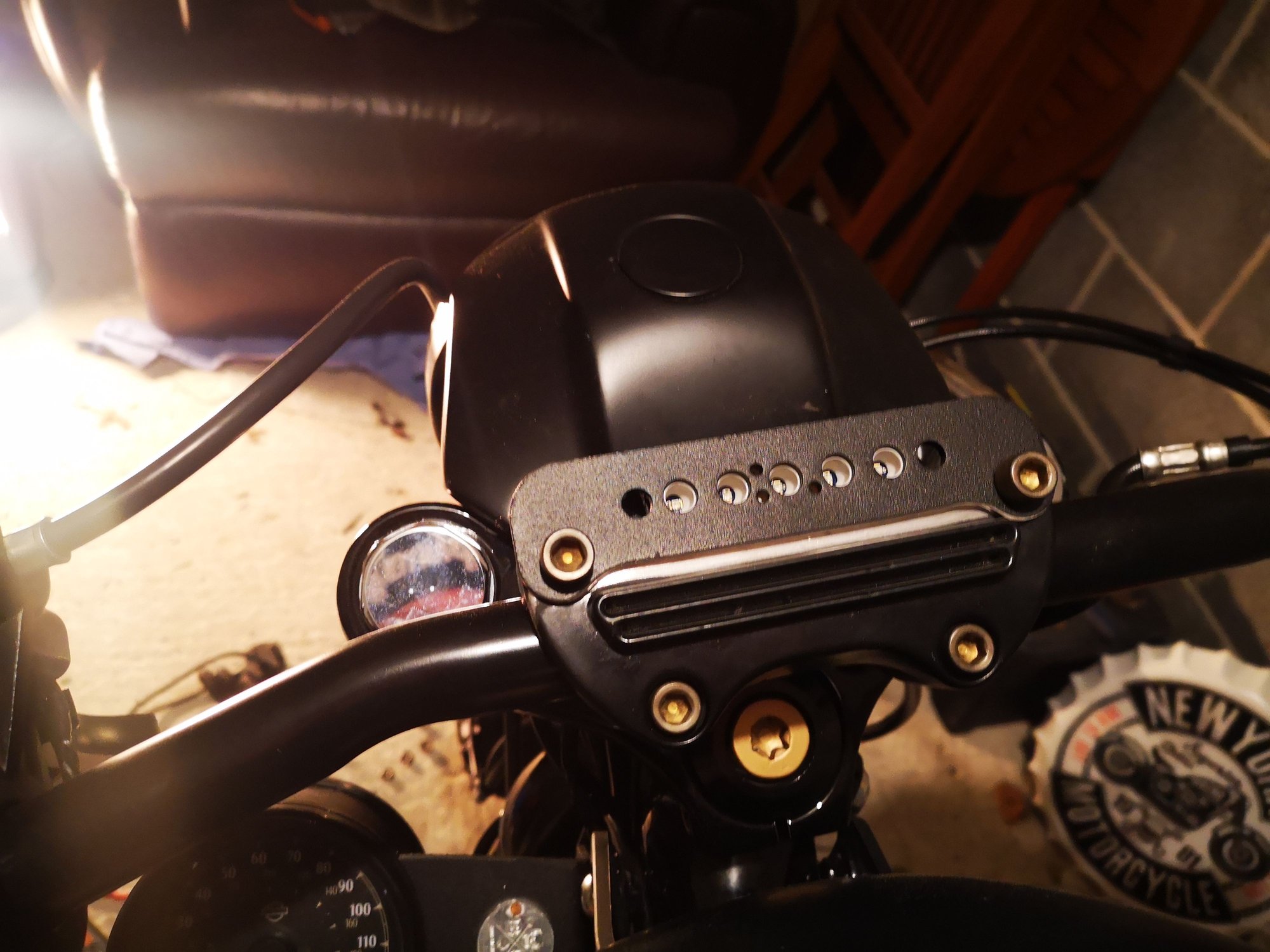

Top bar clamp with gauge indicators.

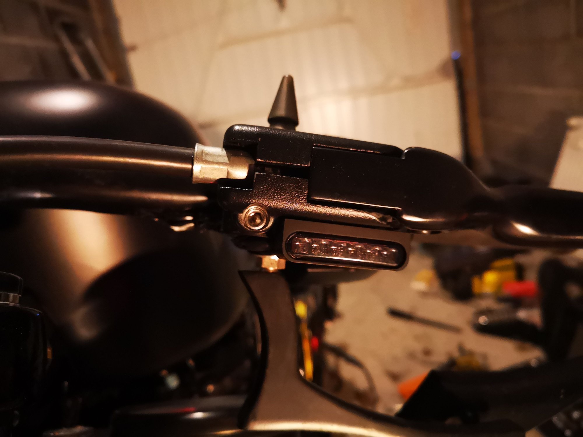

These are the front Indicators this side was an absolute nightmare didn't fit right and the company on eBay where *** holes and wouldn't accept they were wrong or give my money back, so had to make this work i ended up cutting off there mount and weld a small plate on the back to the correct mounting point. Some how it all worked and I didn't cook anything.

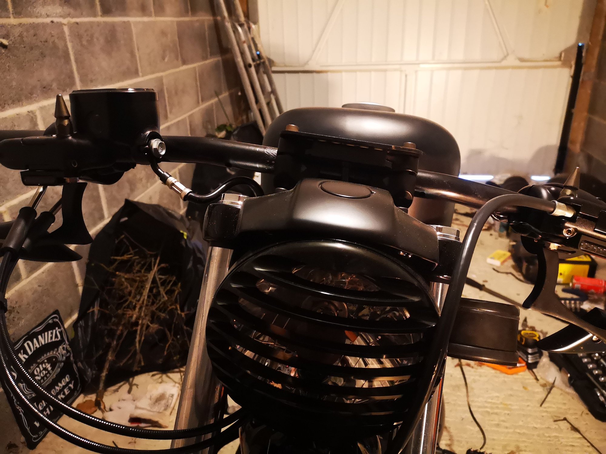

Headlight grill

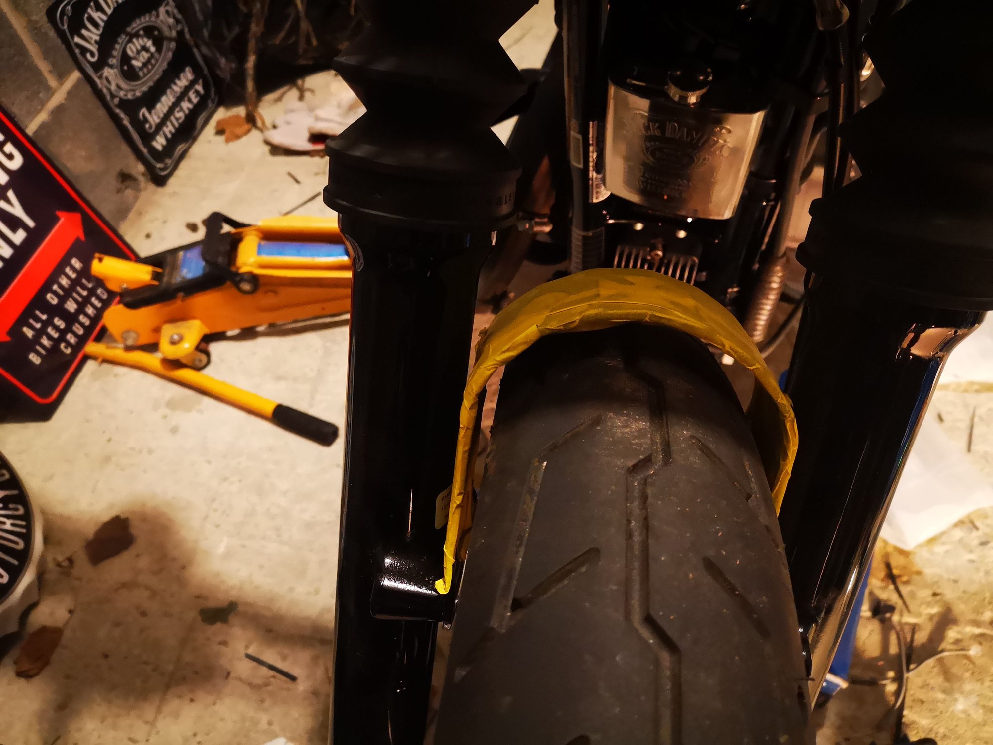

Fork brace still in masking tape but sitting lower

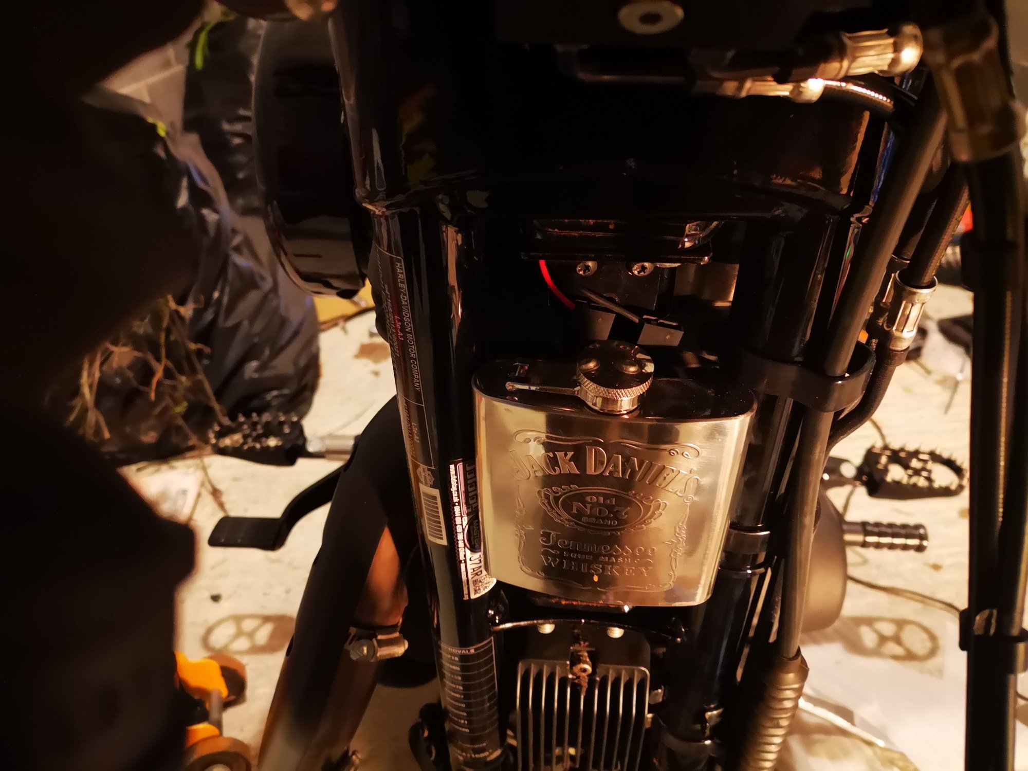

This is my horn cover I made
My door pegs and shift peg

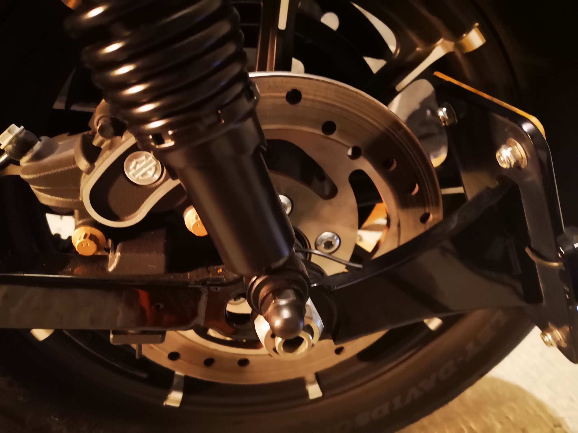

10.5 inch shocks
Blacked out shock mount bolts waiting on the top ones.

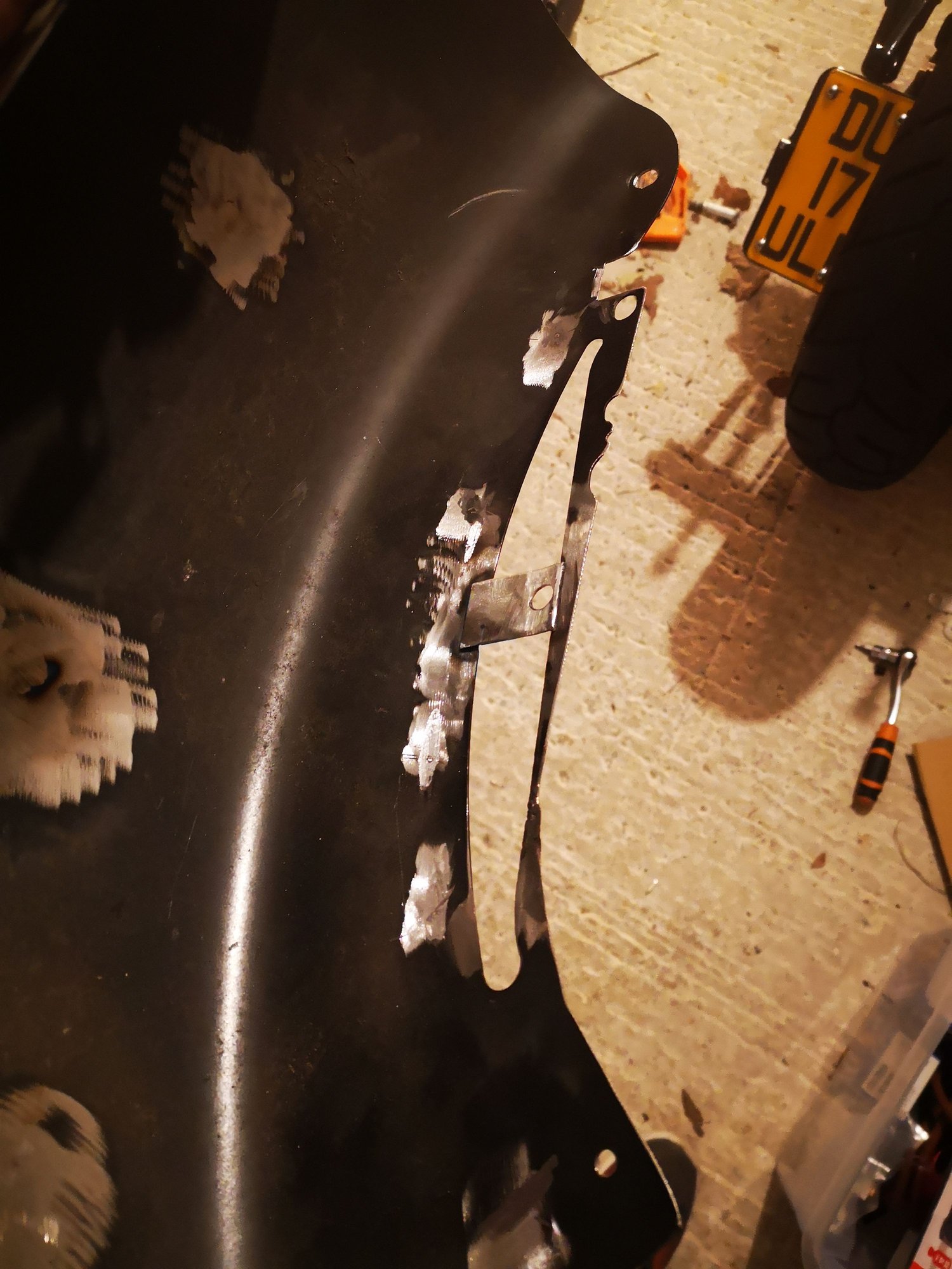

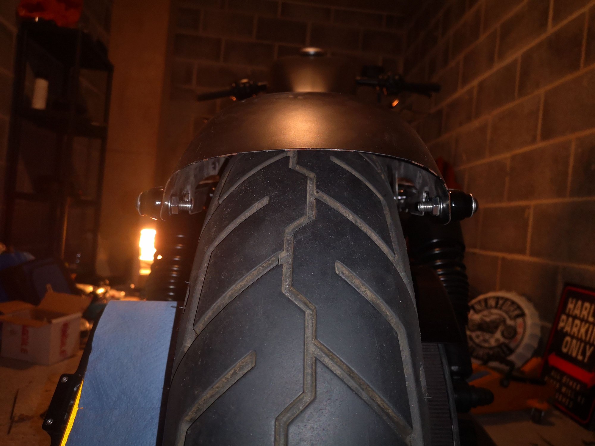

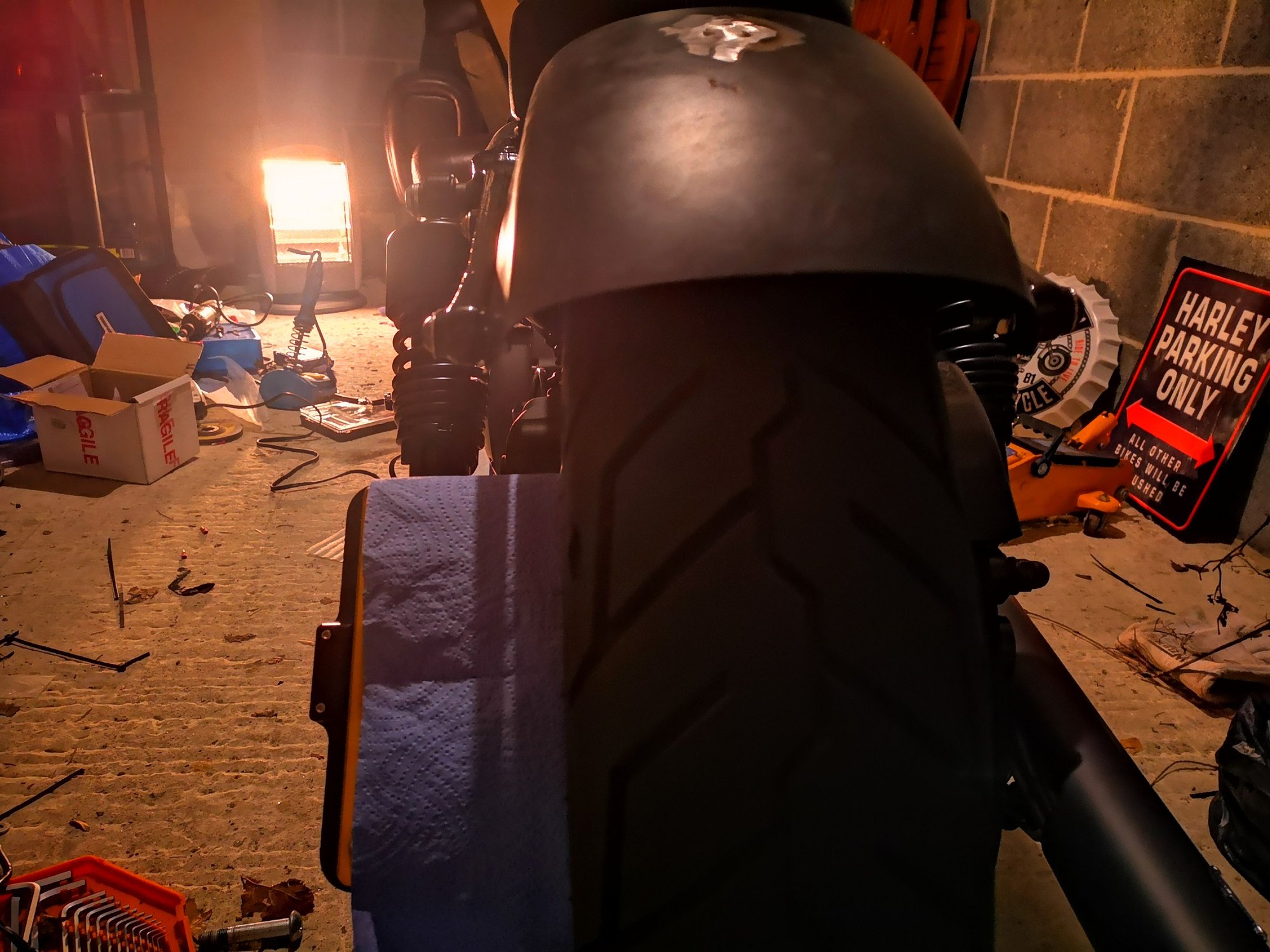

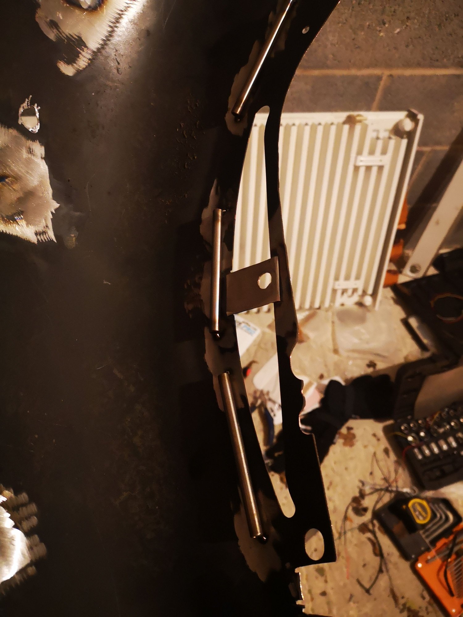

This is the mud guard with all the unneeded holes welded up
The side view had to weld in to brackets so it bolts to the frame rails
New one next to the original
3 in 1 indicators

Need help with this bit
Tried this idea got some small pipe and welded it on the inside to run the wires through. But the wires don't fit all through -_- so need to rethink this any suggestions would be great on how to run the wires trying to hide them all and keep it clean looking.
Had to cut them back out -_-

Originally Posted by squirrelsnest
Nice mods. I like that horn cover!
Thanks wasn't to difficult to do and thought it was different

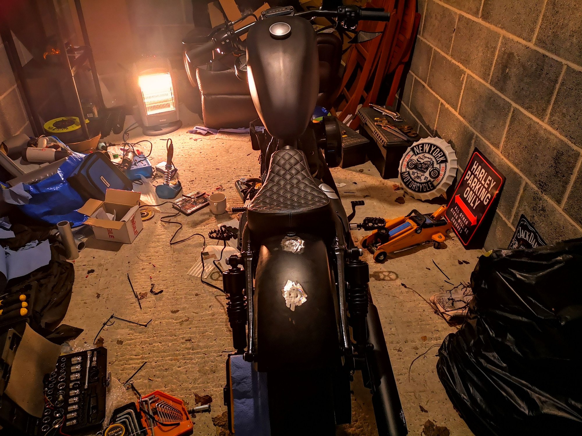

How she sits

Was able to tackle this job the other day looks allot better. Proper pain in the *** todo.

I actually changed the bars forgot to mention it as it was the first mod I did when I got the bike. I've got 1 inch drag bars on there and I run all the wires through the bars as well, that was a pain in the ***, as had to drill and slot them myself.

Looks like a nice transformation. Looks like your bars are a little off center tho

Thanks pal, I haven't set them yet only in mock up as have to pull the top clamp off for powder coating, so just roughly put them on there to check all the controls and indicators still work from all the modding and moving.
