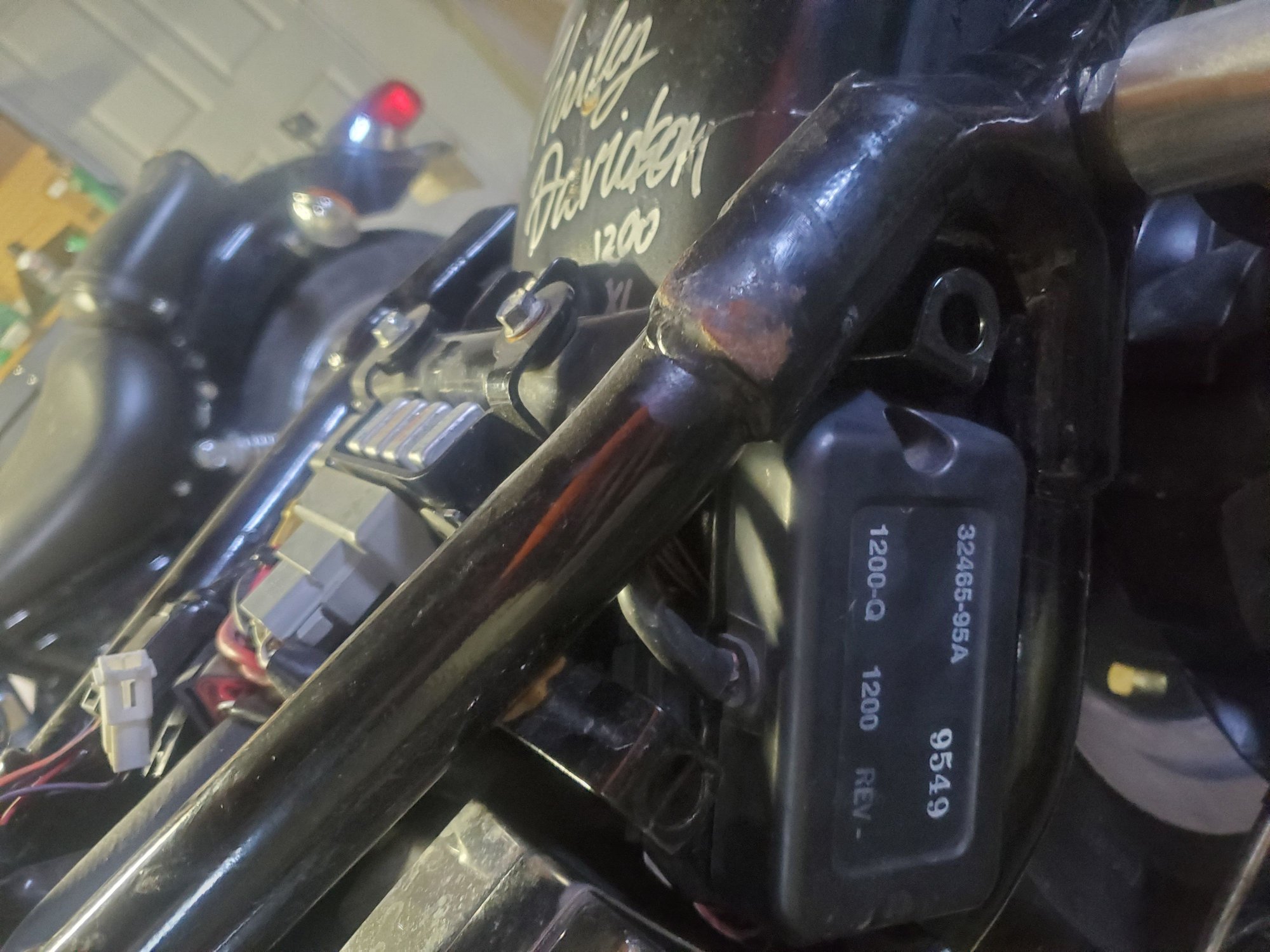

15A fuse. center right on the diagram. fed off the ignition switch. pull and check the fuse, then both sides of the fuse block.

Ok under my seat and side cover this is what I'm looking at. Is there any other fuses?
