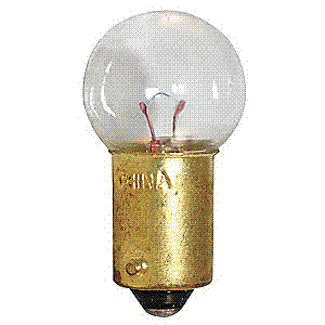

What I know, is if you have an european model of the sportster, you will be using a bulb that has a single contact. It can only be used as an indicator. You will need a dual contact supported plug. See example.
The only way to change this, is to change the entire indicator plug and harness with one from an US model. You could buy one on ebay that is exactly the same as yours
and then swap it out and install something like the RRI Sigz.
