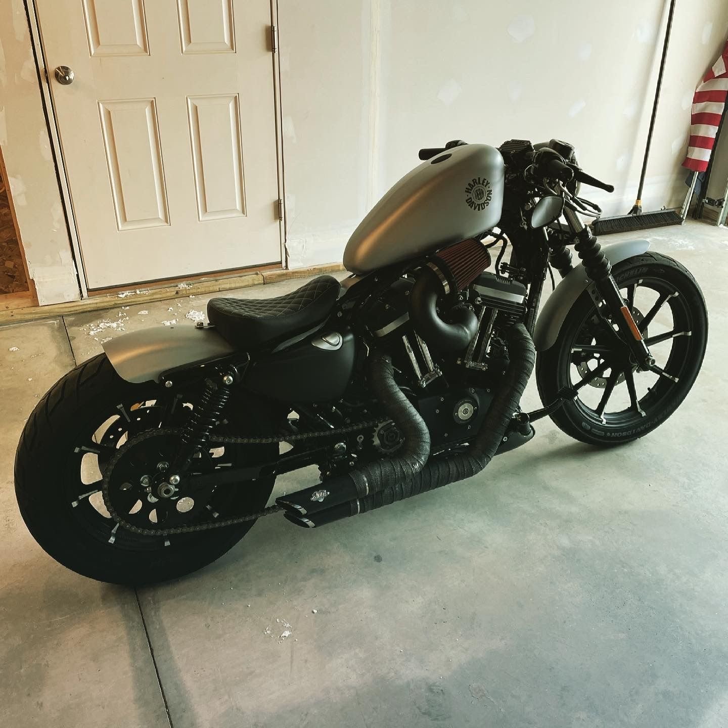

Looking for some help! My bike used to slow crank, and then finally the dreaded starter click. I ended up replacing the factory battery with a performance battery from Harley. Got it back to the house, and installed it. The bike would slow crank and then eventually click, and now when I turn the bike on the fuel pump will prime but when I hit the ignition the bike cycles off (all lights and everything turns off for a few seconds then pump primed again) any ideas? Checked starter connections for corrosion, checked the plunger etc etc in the starter, contact point in the starter are fine, bikes in neutral. I can’t for the life of me figure out why it cycles off now.

Ive never had to deal with HD warranty, but I also know they would have to prove something you did was the cause of it not working properly. Adding a filter or exhaust is not going to mess with the factory electrical system. At the very least they could possibly diagnose the problem and refuse to warranty the work?
Side note, your chain looks to have quite a bit of slack.
