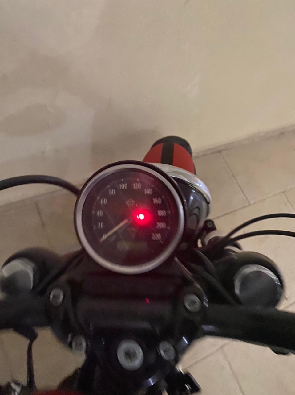

When you turn on the bike does the ABS light flash?
Does it go off if you exceed 25 mph on the speedometer?

When I turn on the ABS light flashes normally. He stops blinking as soon as I start riding the bike.

On the CAN bus bikes it does not display PSSPt.
Once in diagnostics by pressing the trip button it cycles as the pictures above show. I have a feeling the run/stop switch is off hence no display for ECM. It is ECM and not P.
ABS light should go out almost as soon as motion is detected in both wheels much lower speed than 25mph.

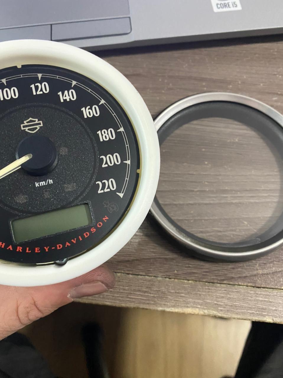

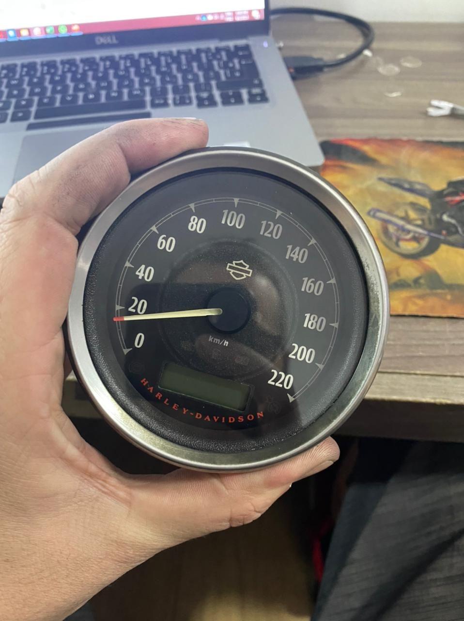

Dear, Good News,
I Resolved my problem. For resolve my problem was necessary two action:
1 - Remove the speedometer
Help Link(reference):
2 - Open the speedometer and reallocate de pointer
Attached pictures
Tks for all..

How did you get it opened up and reassembled without damage?
I thought they were a sealed unit?
Old Jun 4, 2021 | 02:37 PM
rafaellucca's Avatar
rafaellucca
5th Gear
Joined: Apr 2021
Posts: 9
From: Brazil
I followed exactly like the video(second Video). Just by being sealed, you can open it without damaging it.
In the end, I applied silicone so as not to have any problems with the seal.
