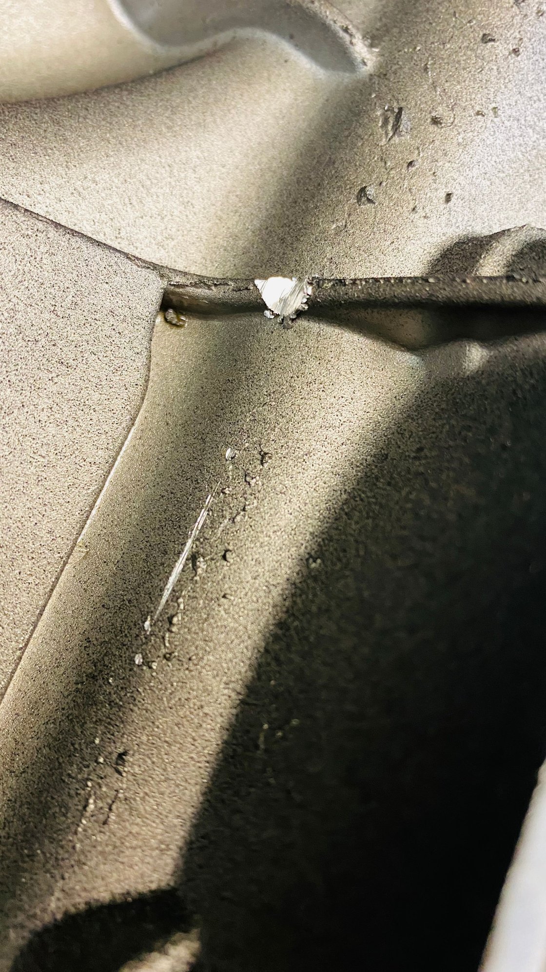

So took my cover off to re thread clutch cable and noticed a chip more like the chain rubbing on the cover. Has anyone seen anything like this?
I check everything and chain and gears look fine.
also it’s from a 2010 48

Primary chain has been run a bit too slack.

Originally Posted by ivanford;[url=tel:20011688
20011688[/url]]Primary chain has been run a bit too slack.
oh okay makes sense. Well hopefully my cable being stripped was causing my clutch to act up when shifting

Has nothing to do with the clutch cable. ADJUST THE PRIMARY CHAIN.

Originally Posted by TexasScooterTrash;[url=tel:20012532
20012532[/url]]Has nothing to do with the clutch cable. ADJUST THE PRIMARY CHAIN.
I just adjusted it and I’m still having this problem.
bike feels as if it is not fully disengaging and doesn’t want to go into neutral also shifting is hard. I must be doing something wrong but this is the second time adjusting it
