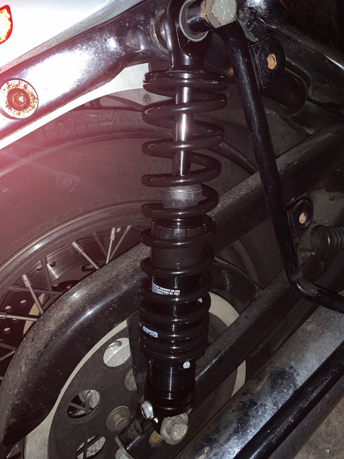

I run 444 11.5 inch heavy duty with heavy duty front springs and a super brace fork brace i like a stiff ride for solo riding and makes for comfort 2 up.
i am 5 ft 8 in 195lb i do have the sundowner seat so the heavy duty is not bad
