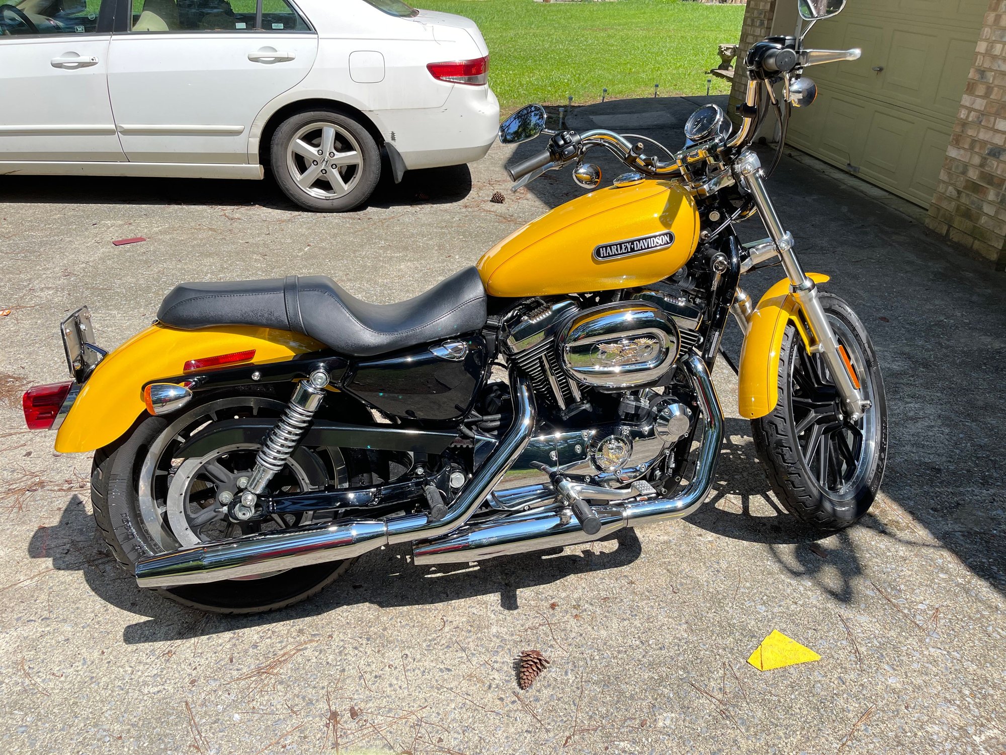

Post up a picture of your bike. Should be easy enough to tell the size of tank fitted.

should be the 4.5
Its a Low

i am no expert but i think you may be right, looks bigger than my 3.3.

After looking at pictures of various bikes including my own it does look like a 4.5 gallon tank.

By the way, love the yellow !!! I have a 2011 TriGlide and get 160-170 miles before low light. They say it should have a gallon left at that point on a 6 gal capacity.
