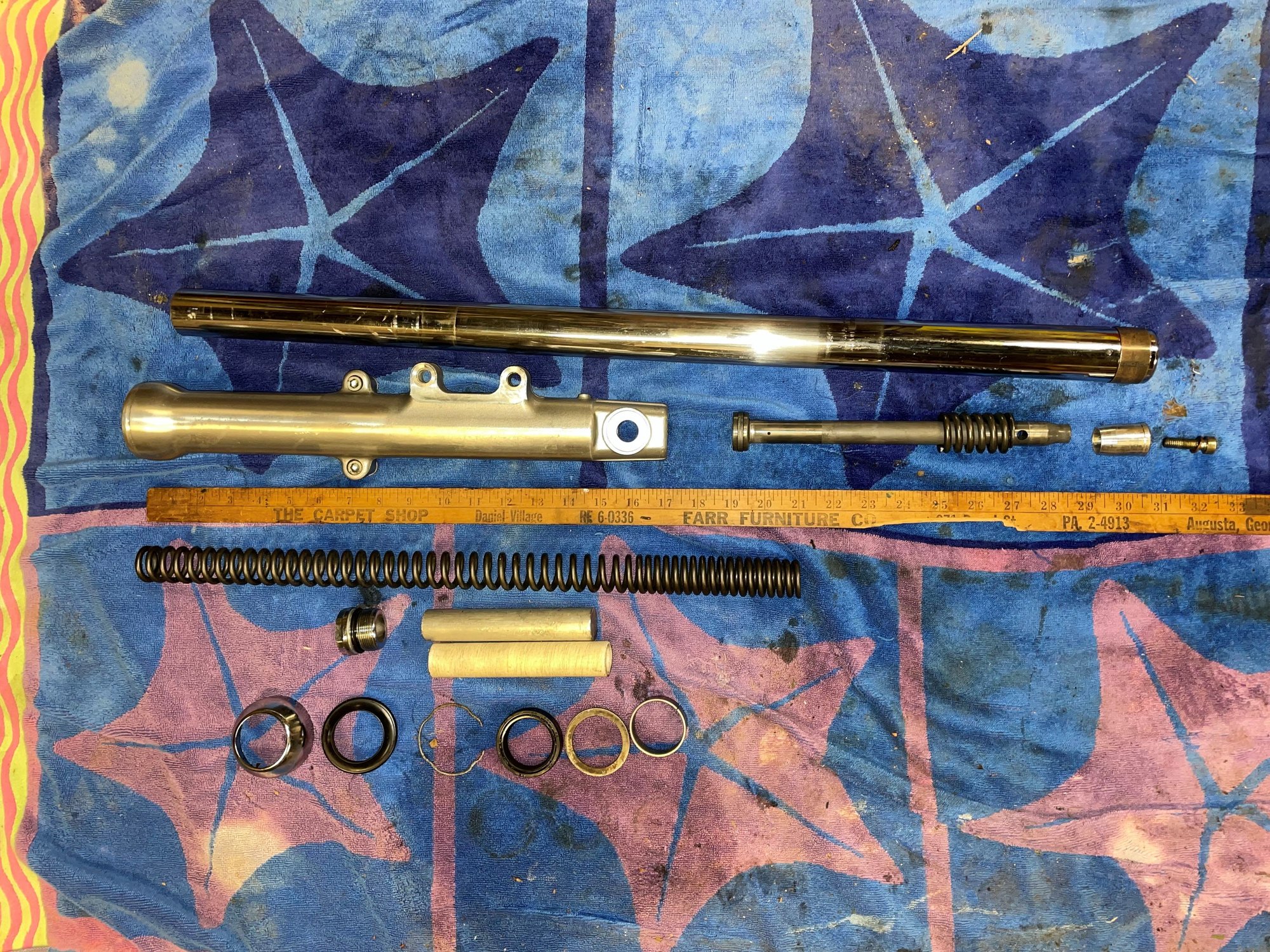

Here's what my weekend turned into. I completely disassembled the from forks. The fork tubes O.A.L. was around 29.250" from end to end. It had an aluminum spacer on each side instead of any PVC type spacers. One side barely had any fluid, with only about a shot glass amount poured out. Both sides the fluid was black as could be. I pretty much just cleaned up everything and put back together for now. I did replace the aluminum spacers with a piece of 3/4" PVC pipe that was a 1/4" longer just to see what difference the ride was. So new fluid on each side with the amount my owners manual called for (10.2 oz). It was rainy here all week end so I didn't get to ride a long time to see how much difference it rode. There was a little difference in the turns just the little bit I rode it. When I get back home this weekend Ill take it on a longer ride and see how it goes.
So now knowing the length of the fork tubes, are these considered the 2" over tubes, or what size would be considered?

That would be 5" over. What were the spacer lengths?
What Brand and WT fork oil?

+6
