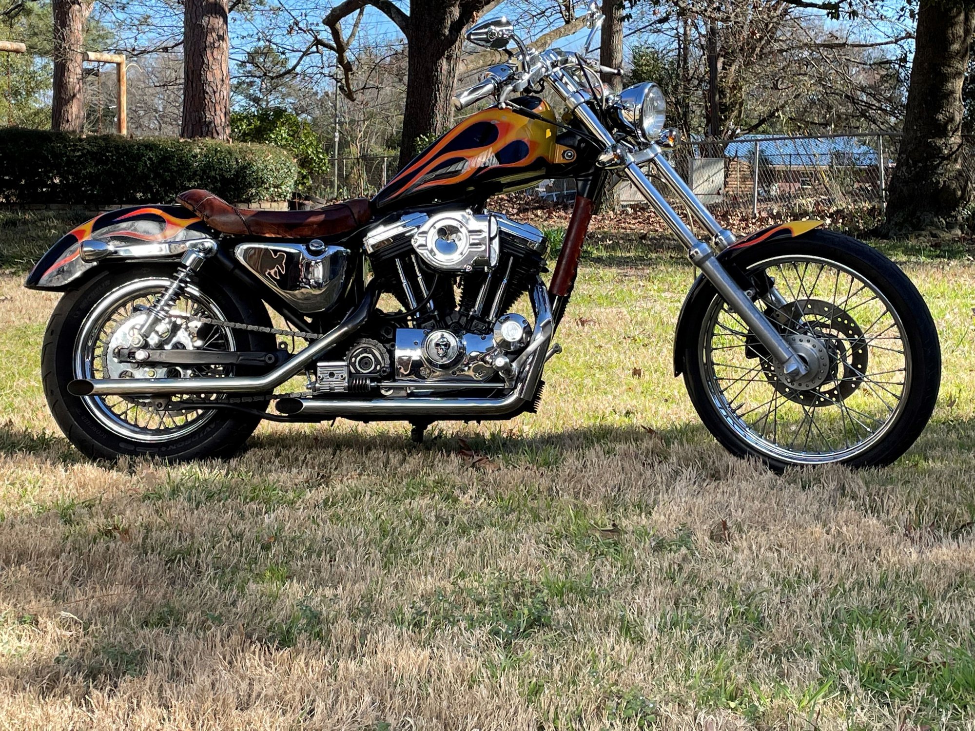

Not 100% sure. This is my sportster.

Good looking ride. Looks well done, so it's a good possibility the extension was done proper.
Maybe try a fork brace.
You may just need to play with the fork oil wt and quantities, maybe just upgrade to cartridges or emulators/intiminators.
