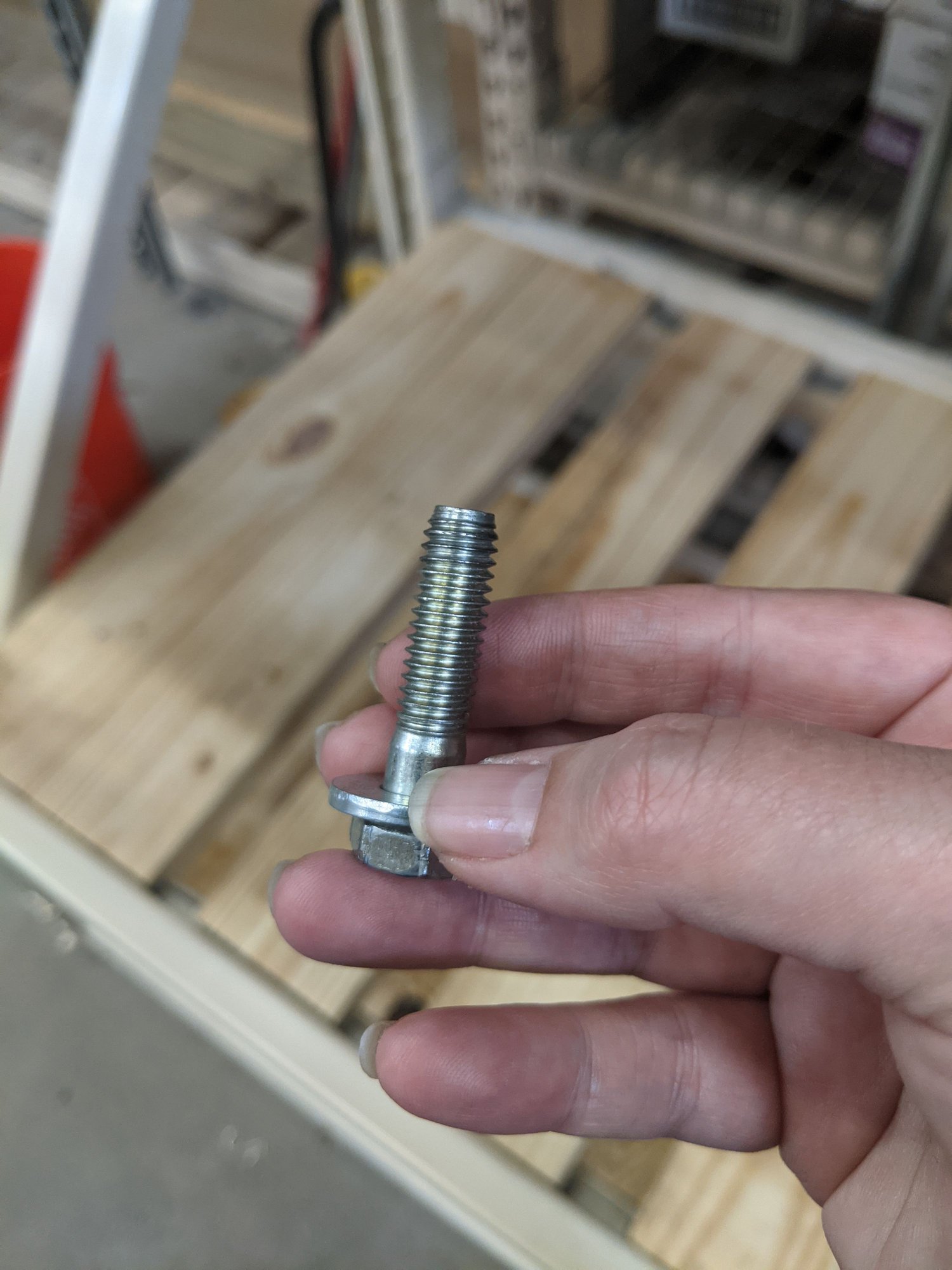

Can't post pics at moment at hardware store now looking for a tap.
But not sure if bolt is sae or metric??
