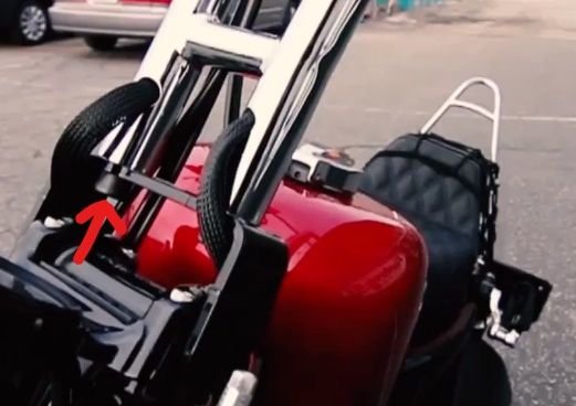

Hi,every riders,i have a question need your help.my bike is 2015 fortyeight,now i prepare install a wild 1 wo562 T handlebar on my bike.i don`t want to change my up triple,so i bought a factory47 adjustable bracket,for install my bars.
when i watching factory47 video,i found they hold bars bolt`s head very huge. just like photo shows.i contact fatory47, try to buy bolt,they refuse,so i looking for bolts on internet,but i have not found any bolts like it.so ,some one can help me
what`s bolt?type,size,any useful mesage,thanks.
ows which bolt is that?if can give me some advise,thanks very much.

To Andy:buy bolts is easy,i just want buy photo show bolt,let me feel it`s more stable,thank you.

buy bolts is easy,i just want buy photo show bolt,let me feel it`s more stable,if can`t buy same bolt,i just buy 2 1/2 13 tpi bolt for my bars.thank you.

I think he already knows basically the correct size and knows where he can get typical Hex Head Cap screws, but he wants to get the bolts shown in the photo (Socket Head Cap Screws) ... as I interpreted from below

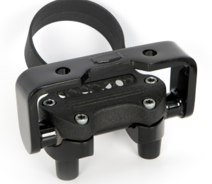

Pretty sure hes asking for item 2 below. Shows to be PN 3605 which shows to be a 1/2"-13 (course thread) 2.5L hex head. Id also pick up a washer. Ebay link for ref. https://www.ebay.com/itm/NOS-OEM-Har...-/221904768123
