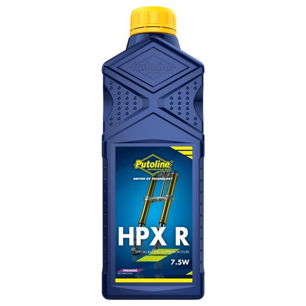

Have you decided which formulation of transmission oil you are going to use yet?
I put Putoline Formula V-Twin semi-synthetic 20-50 in my Sportster and it loves the stuff. It is formulated for V-Twin motorcycles in The Netherlands by nice friendly clog wearing Dutch people. It costs me Ł34.00 for four litres, but it's worth it's weight in gold to me.

Puto Line? I'm guessing they don't sell it in Spain or Mexico. "Puto" is a pretty foul expletive in Spanish.
John
I'm not sure if Putoline export their lubricants to Spanish speaking countries, John.
Putoline only produce lubricants for road, racing and off-road motorcycles.
Pucky
