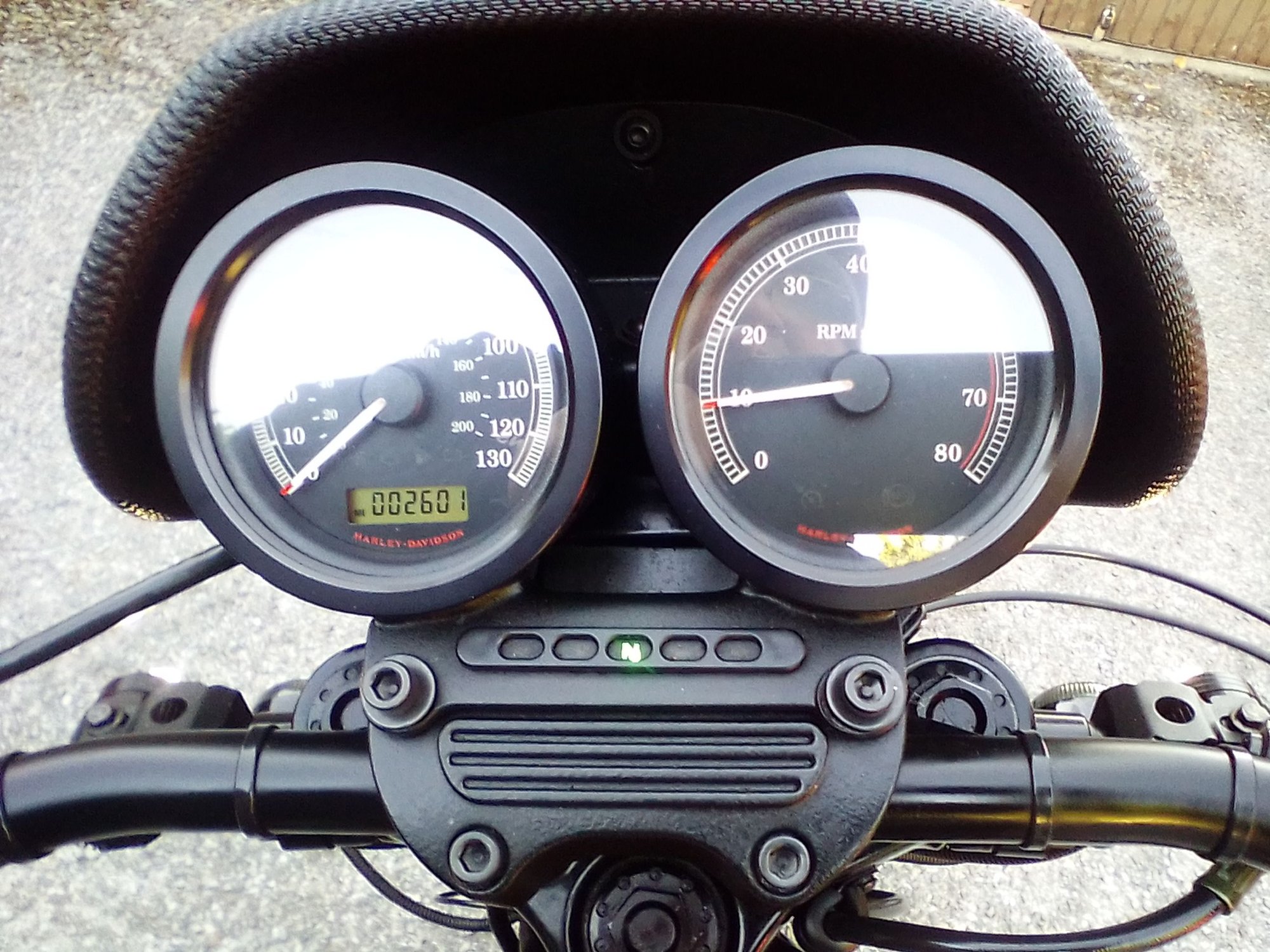

How about a link to your revcounter or tach for us westerners?

Originally Posted by inspecto
How about a link to your rev counter or tach for us westerners?
My tachometer upgrade kit is H-D part # 67182-07, it costs $347.95 in the USA. It is a plug and play kit. I had to buy a separate handlebar clamp to mount the dual clock mounting bracket.
The kit contains everything you need to install and has full step by step installation instructions. I prefer the look of dual instruments, the fill my fairing nicely and the tachometer is handy for keeping an eye on how high my motor is revving.
The outer bezels on my instruments are an aftermarket item from AliExpress.

Thanks for the info and like you I like the look of twin gauges and it's always nice to know your rpms
