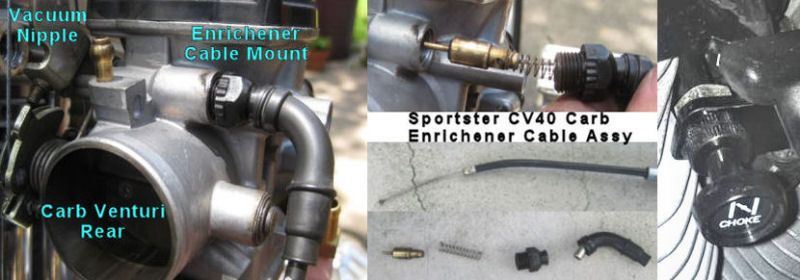

Probably need to clean out/adjust the enrichner circuit (choke) if it is just starting hard and runs good when warm.
See: http://sportsterpedia.com/doku.php/techtalk:evo:carb02
Enrichener Function (Choke)
The CV40 has an Enrichener Circuit - It is labeled Choke on the ****, but that is a misnomer, because a choke refers to a plate that restricts the incoming air supply. The enrichener circuit actually provides a path for additional fuel to bypass the carb controls and be injected directly into the air flow at the rear of the carb venturi.
Typically, the enrichener should only be utilized when starting the engine when it is completely cold. Put the enrichener on, let the bike idle for 1-3 minutes, then ride off. Turn the enrichener off as soon as the engine warms up (perhaps within 3-5 miles of riding)…
On a warm or hot engine, you may need to twist the throttle 1/8-1/4 turn to shoot some gas in before starting.
But do not use the enrichener unless the engine will not idle properly.
If the engine won't idle, pull the enrichener **** out enough to get it to idle, ride for a couple minutes and push the **** back in.
Both excess use and insufficient use of the enrichener may cause poor performance, erratic idle, poor fuel economy and fouled plugs.
The Enrichener **** is a friction function device. When mounting the ****, do not overtighten the mounting nut. The resistance/friction on the enrichener cable can be adjusted with the knurled nut.
  • Loosen the hex nut & remove the cable from its mount.
  • Put an adj wrench on the flat part of the cable mounting sleeve.
  • Carefully turn the knurled nut to loosen or tighten the tension until the **** stays pulled out on its own yet freely can be pushed back in with reasonable pressure.
  • Remount the cable with the lock washer behind the bracket & tighten the metal hex nut carefully (not over-tightening).
Check that the **** moves freely in and out after mounting.
The fuel for the enrichener circuit is drawn thru a fixed jet in the float bowl. The air for the enrichener circuit is taken in thru the banana shaped inlet at the top of the carb face (see the face pic above). Sometimes when the enrichener cable is moved, or the carb has been taken off the manifold, the valve piston does not properly seat into its cavity on the carb. If that happens, additional attention must be given to properly reseating the enrichener valve piston.
