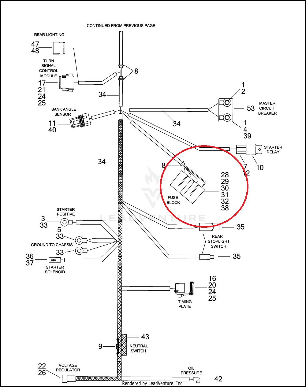

6. Have you checked all your fuses and behind the fuse block panel (#14) for corrosion?
