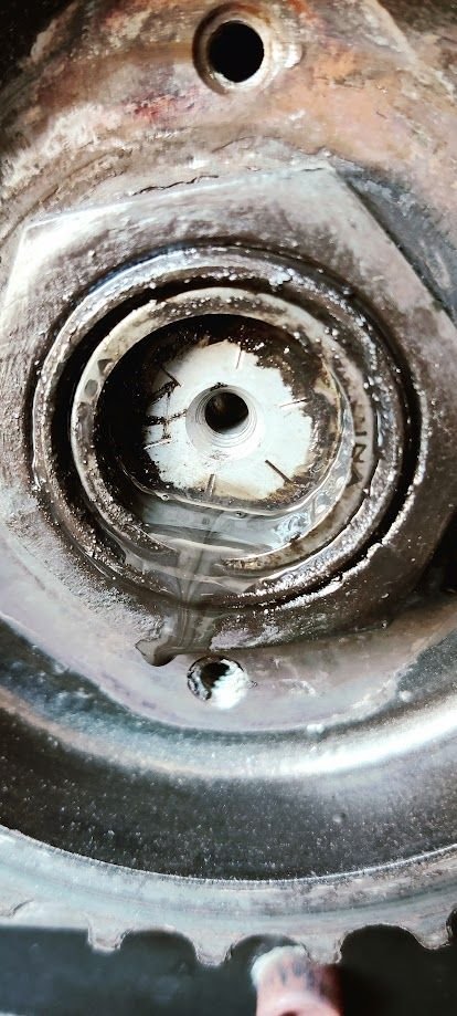

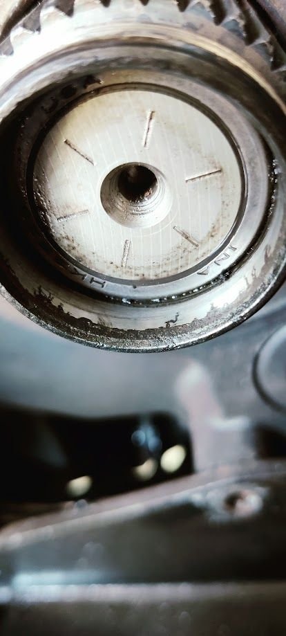

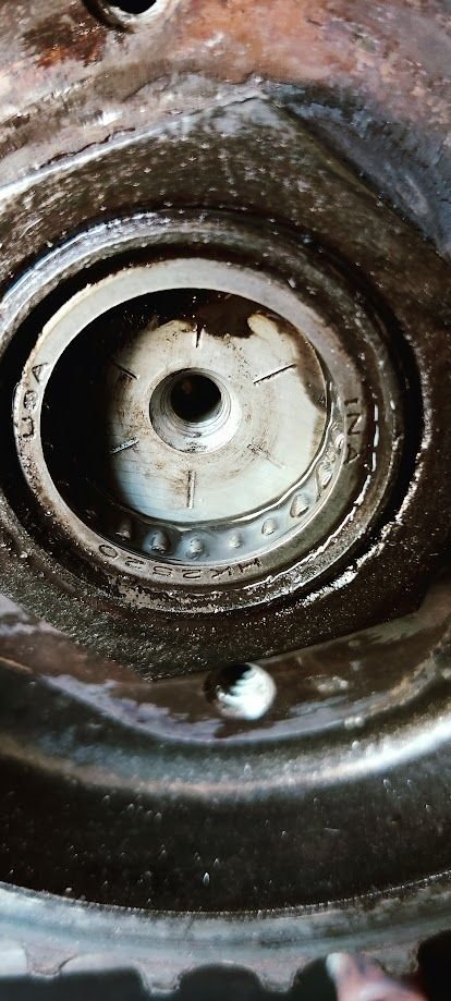

I have a question,
I had a whining noise on my gearbox and I noticed that the needle bearing was out of place (where the belt mounts on), any ideas why it was pushed all the way out? I have now pushed it back in with a socket and hammer and replaced the missing rubber seal but am noty sure if it will happen again.

If you look at the first picture, you can see all the metal dust in the oil. That in itself ,would warrant disassembling and replacing whatever it was that failed.

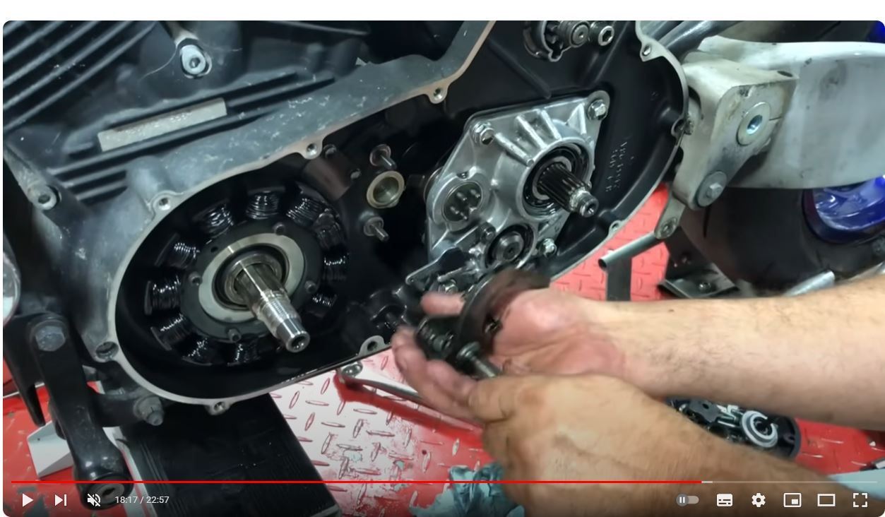

Is that your motor? That looks like a trapdoor transmission, are you sure you have a 2004+ bike? The 2004+ bikes should not have that trapdoor, it's now part of the right side case half, you have to split the cases to service the transmission.
John

No its a youtube video I found, I will continue looking for one :/
