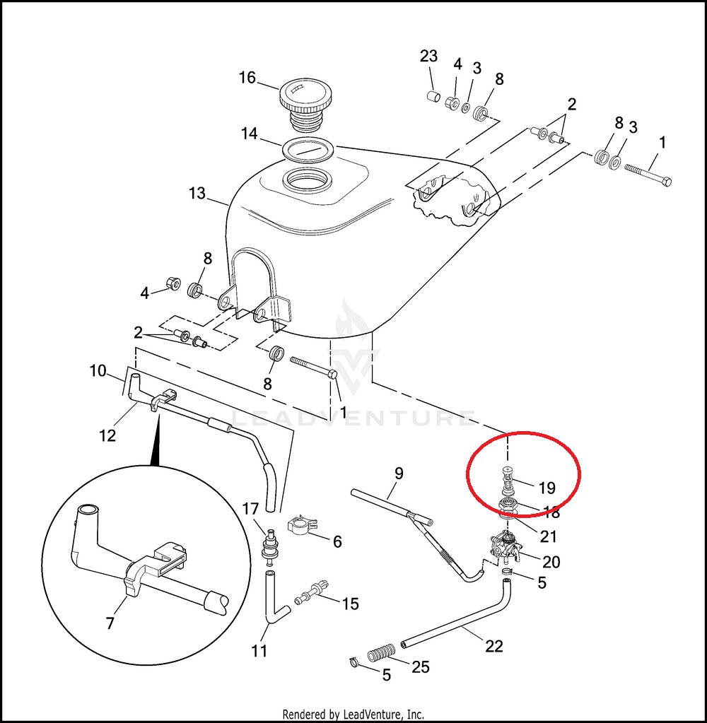

Filter between the tank and carb will cause additional problems.
There should be a filter screen on the petcock if it is OEM and that will do just fine to keep crud out of the carb.
Ref:19
62166-81A
FILTER FUEL VALVE

Get a filter between the tank and carb if you don't have one already
Don`t do this on any Harley.
