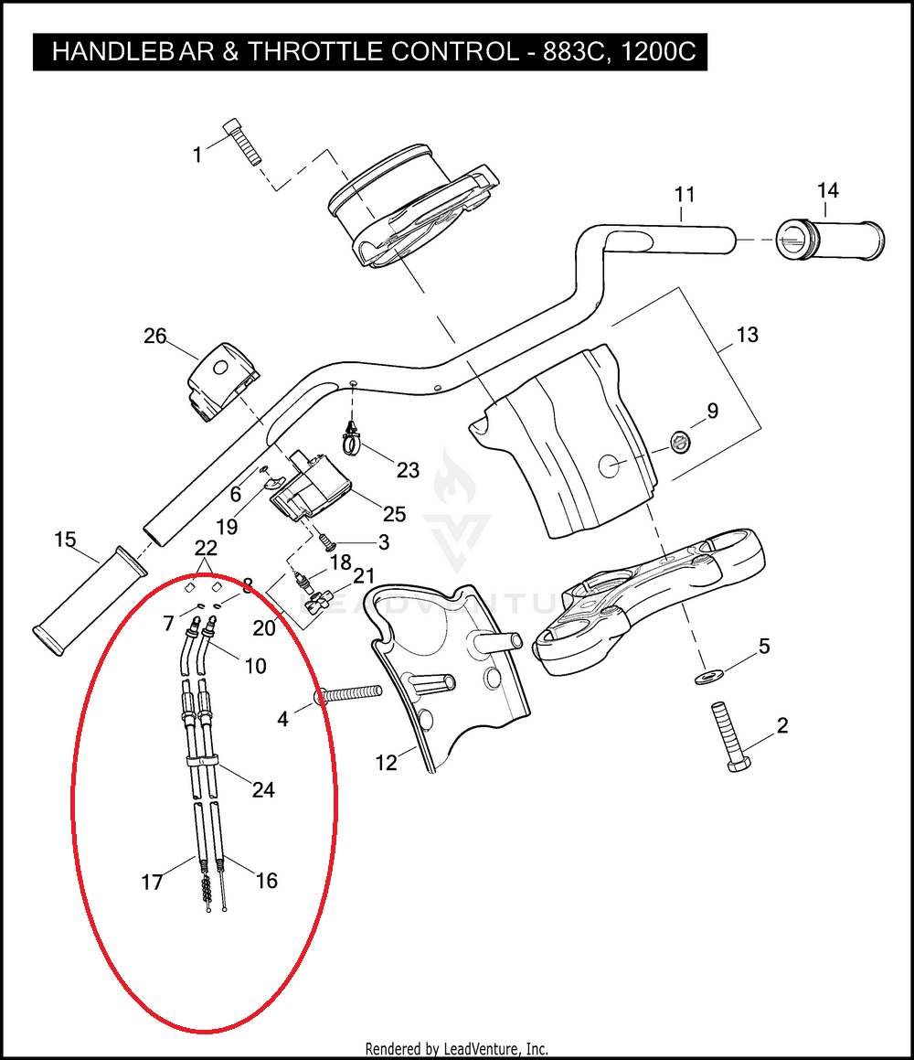

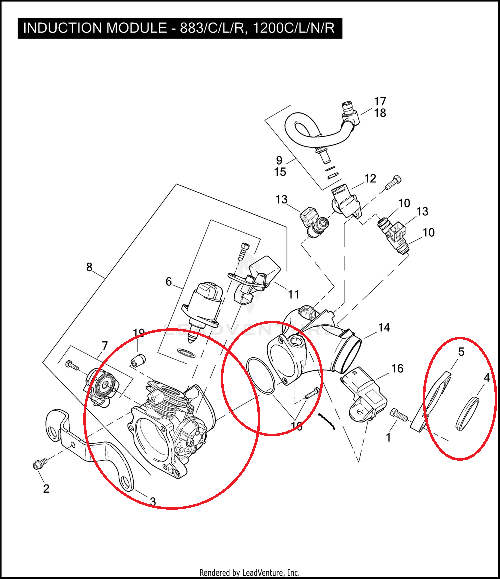

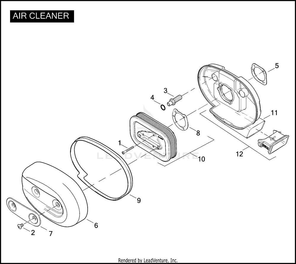

There is really nothing to do with the transmission on the right side, now the left side you could have damaged the shifting mechanism. Have you checked for any trouble codes? Any damage to the fuel injection throttle body? Did the air cleaner hit anything? It sounds possibly throttle/intake related, maybe dislodged the manifold and throttle body? Check throttle cables and the throttle barrel for function.

1. If it went over hard and hit the Air Cleaner, it could have possibly damaged the induction module or other parts in there.
2. May have damaged the throttle control assembly also. Close inspection will tell the story.
