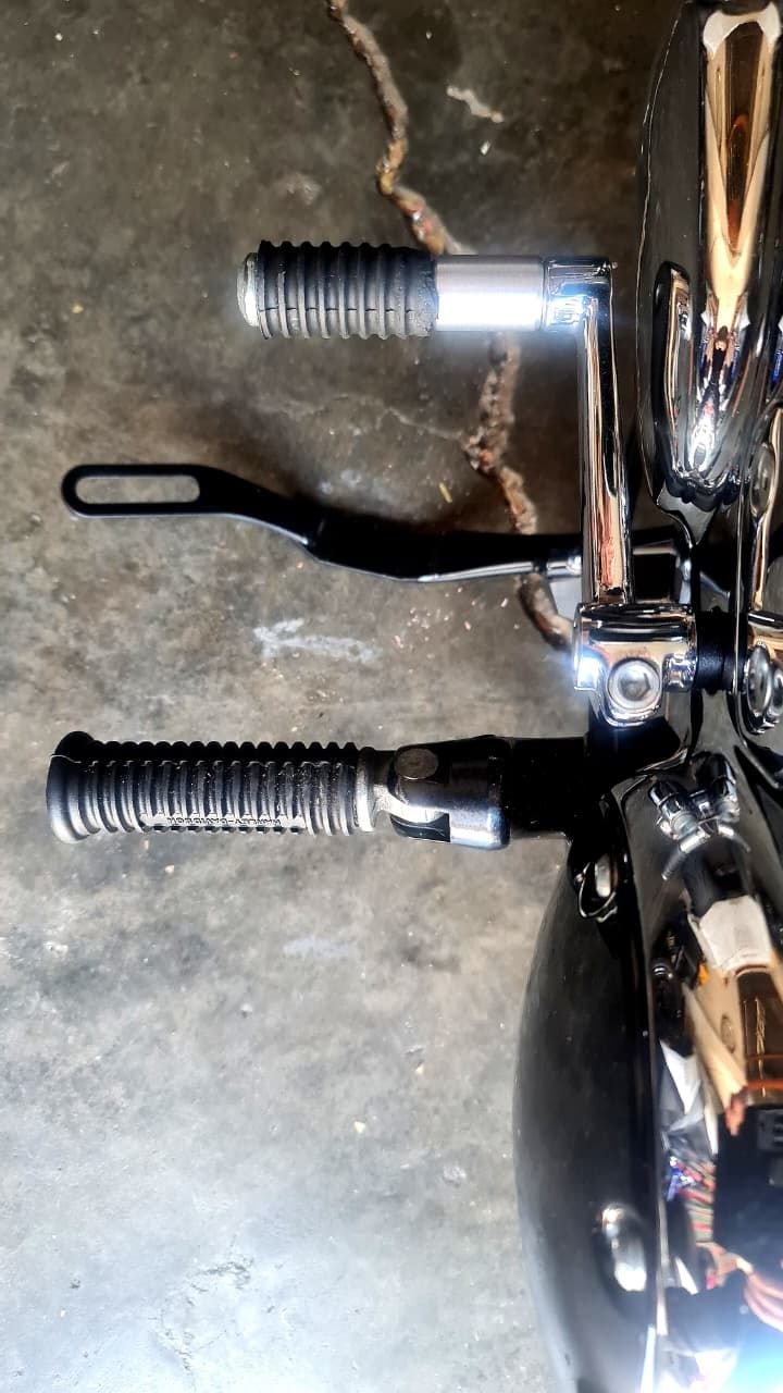

Yes! I fabricated thin metal shims and wedged them between the peg and the bracket. It lifted the "hanging" front pegs and did a great job of preventing my feet from sliding off. I also extended the gear shifter because it is so short.... I made a aluminum spacer on the lathe, cut the retaining bolt in two, welded a 33mmX10mm metal rod in between and now it feels much better!
