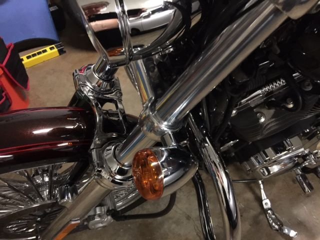

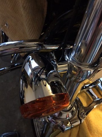

Default Yeah, thanks, I did have to pull the Tank
I did have to pull the tank in order to do it correctly on my 2013 XLC and finally got er done. See my albums, im a HDforums noob, dunno how to get all them pics on this post.

Kind of late but just a FYI - if you still have your stock visor and headlight, you just needed to remove the left side bolt holding the visor to the fork (loosen the right side) to get the signal down in the fork. On the right side, routed the wire along the hard cable/conduit behind the fork to the lower triple tree...hides the wire nicely. Did not touch my tank or turn signal harness.
