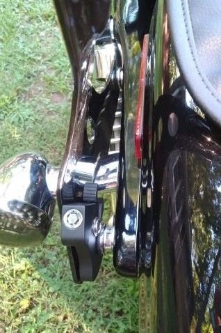

Unfortunately the instructions on fitting may not be all that clear but the lock has to go on shall I say up the other way compared to how the non locking catches fit thus the key hole is facing up. The locking catch looks naff as it sticks out and is not inline. You also need to change the non locking catch upside down as well on the other side.
I had to break one of the keys to use just the little bit to get the catch unlocked as I had fitted it wrong the first time.

I also broke off the key as you did and cut off some of the excess plastic in order to be able to fit it in beside the curve in the sideplate. Used a needle nose plier to turn it until it released, then switched the latches from "inner (relief hidden)" to simply "inner." Am happy to have the option to remove the sissy bar if I wish.
Don't like it that the locking latch isn't flush but it's the only way to be able to access it.
