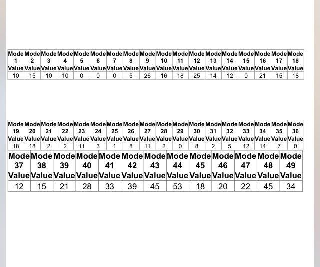

Got the Fuelpak LED for it last year (regretted it), with the idea of re-adjusting fuel because of the cams. Well, there were no such FP maps for this layout, after a couple of emails the tech sent me map FP-918. The bike started gobbling up lots of fuel, mileage under 30mpg. After some more emails with as accurate description of the issue, the tech changed several values asked my to try it. No real change in fuel mileage, although the bike woke up a fair bit. So, I took it to dyno shop, asked for specific fuel graphs at various throttle openings, rpms and loads, WITH THE FUELPAK REMOVED. My way of thinking, send the data to V&H, they'd zero in, rather than guess. The tech emailed me back with some further adjustments, objective is improvement in fuel mileage. As a sidenote, my 02 FLHT, carbureted, 95ci, V&H ProPipe HO, Mikuni 42mm, SE Ignition, SE Air intake, Andrews TW26 cams, mild head work (9.5:1 static compression), is getting a consistent 40+mpg.
Fuel mileage improved by 2mpg to 32 mpg, not impressed. While I'm educating myself on the next fuel management system, I decided to also find out as much info about these FuelPak cryptic mode sets. Thanks to this thread, I've put together what's been tried so far and further adjustments of my own, all changes highlited in RED. I've included 2 more maps, one for stock config FP-0030. the other Stage I FP-0032. There are still 13 modes that are "in the dark", so reading historically backwards, I'm trying out mode value adjustments in measured steps.
I have a theory. Stage I fuel feed without the 26s, can't be that far off with the 26s. They're a mild, torquey cam, and I know a lot of folks who are using them with a Stage I flash only, without any negative effects. I'm sure power would be improved, but the basics work. Now, the theory....if all associated FuelPak modes were at 0, would that not make the Fuelpak add nor subtract zero fuel from the Stage I fuel map, anotherwords be neutral...(I understand the perils of a lean EFI fed motor.)
If anyone has something to add, please chime in. I'll post updates on further adjustments and their behaviour on the Softail.
