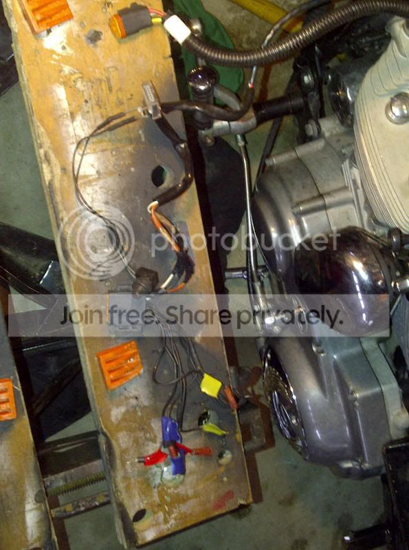

Now I have the tank all removed, but now I have the issue of figuring out what i need to replace my ignition switch since I plan on getting a new tank without the cluster on the tank. Really what is scaring me is all the wires that i seem to have hanging around now.

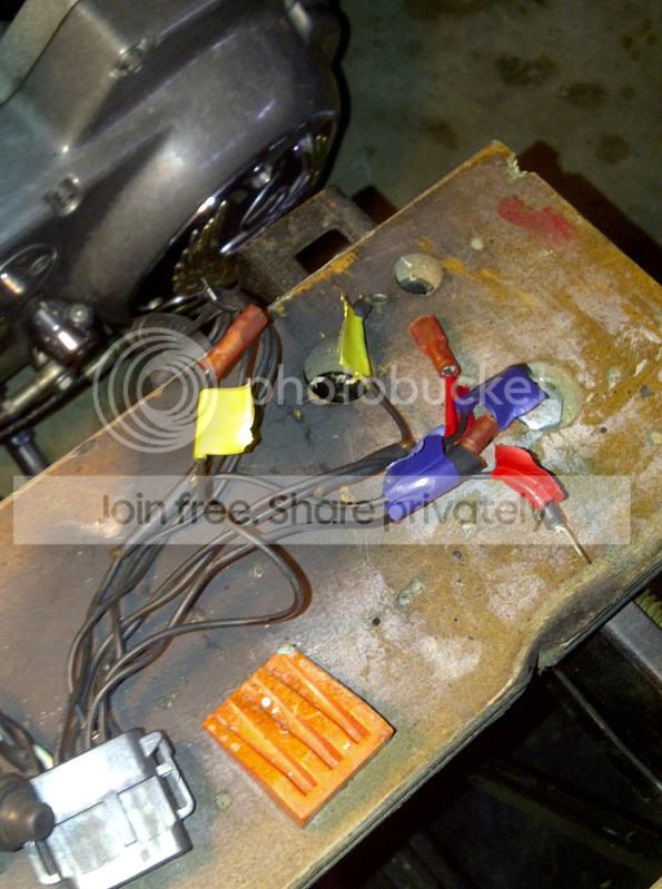

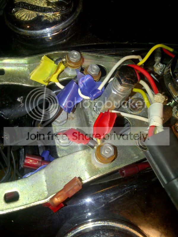

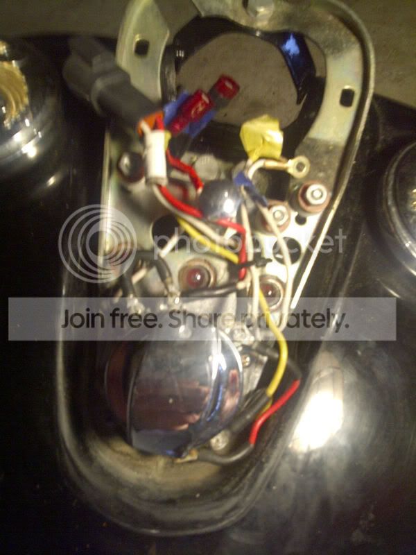

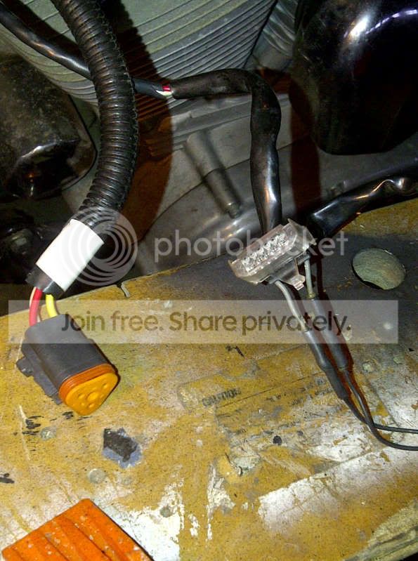

Here are my scary wire pictures. Im not sure what was added to it and what is original. If you can kind of point out what i need and dont need that would be great, but if not its fine, i can figure it out, but it would help a lot.
(sorry if some of the pictures are not great)
here are the wires when they were still attached to the tank, the ignition switch is off to the right for reference.
These are the wires left on the tank after i disconnected most of them. The quick connect there i believe is what connects to the actual ignition.
On the left is the other end to the ignition connection, and the right is the connection to the speedo. These ends are what is still wired into the bike.
Here is another look at all the wires still connected to the bike. sorry for the bad angle
So after thinking and looking over this i want to say that maybe these wires are kind of extra? these are just for the connections to the actual ignition switch on the tank i think???

Why not get the stock ignition switch from a dealer? Then you can mount it in the original stock position, or get a F6 ignition Relo kit.
Here is a link that will help you with your wiring.
http://partsfinder.onlinemicrofiche....ake=hdmc&A=146

Got my new ignition on! thought it was going to be a lot harder since i wasnt sure what was changed on it before i even got it but everything works great. It was just the 3 wires i had to splice together and that was it. i was worried my headlight and blinkers wouldnt work since the other ignition had a ton more wires and stuff. Here is it though, im pretty happy with how it turned out.
