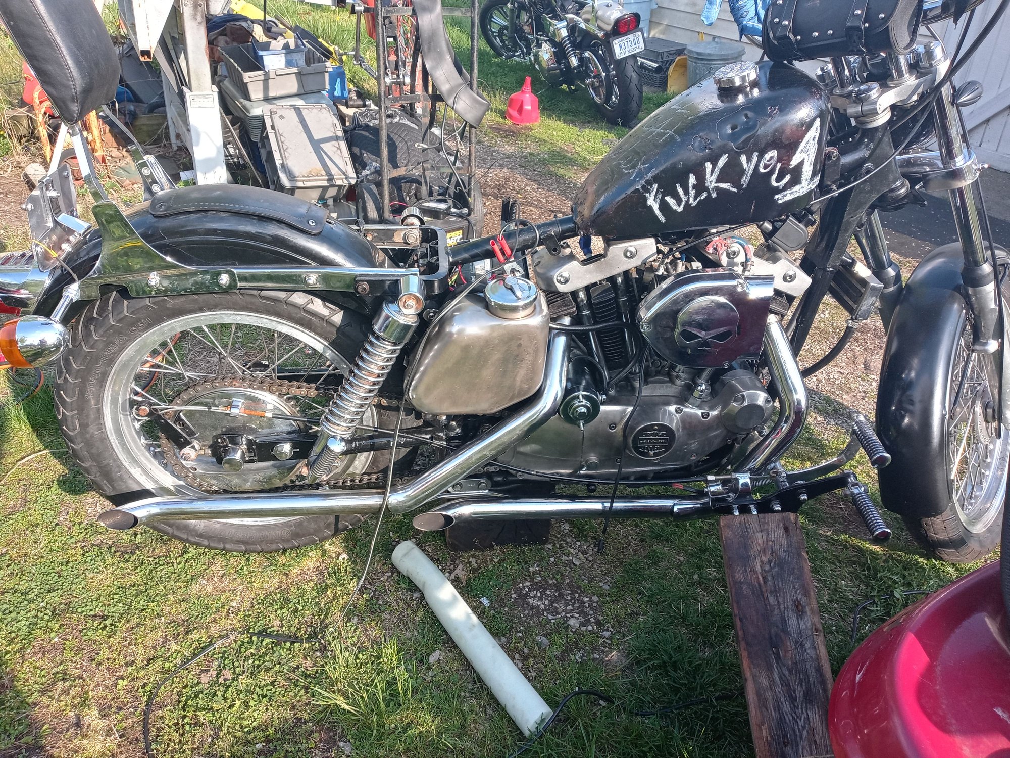

Default I have a sportster titled as a 79. The vin matches on the title
Originally Posted by Priest78
How do I determine what engine year and size I have with my custom sporty by the engine case number? I know the VIN on the frame is suppose to be able to tell you but how do I figure it out from the engine itself?
the vin title and frame all have the same number
3A36133h6
I noticed something was weird cause it has mechanical
Brakes old style oil tank and the primary chain adjuster
is inside the primay case
So i looked up the vin and it has h6 in wich to me say its a 76
anyone ever hear of this

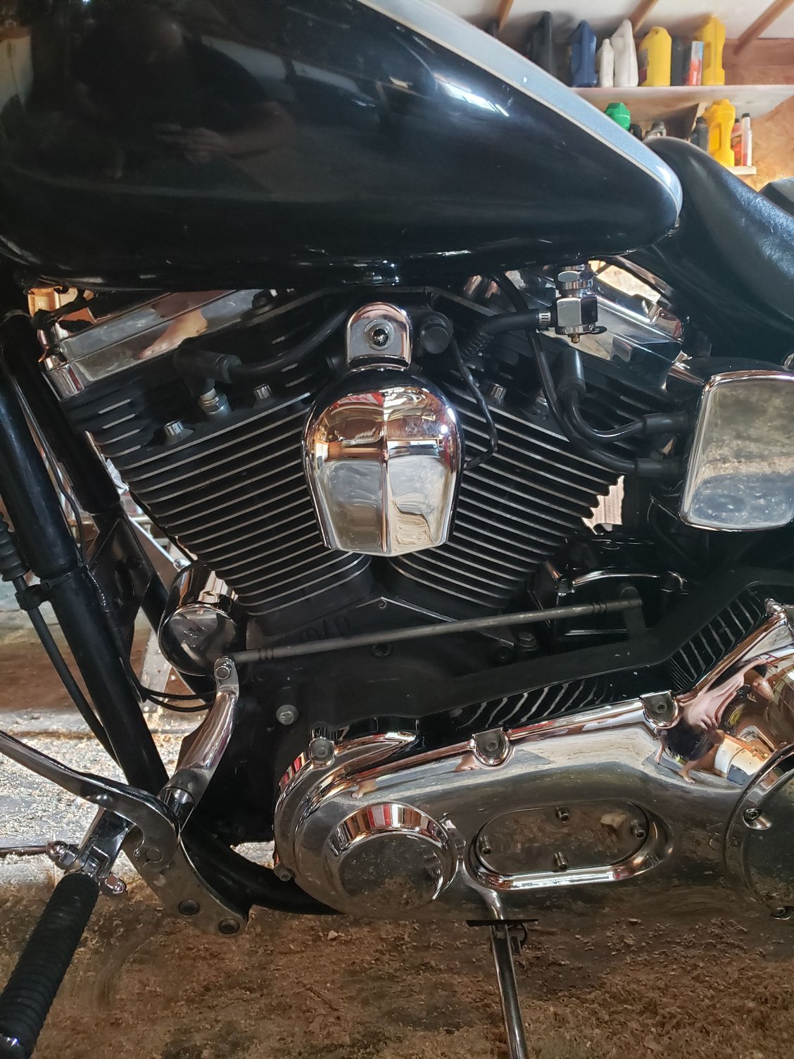

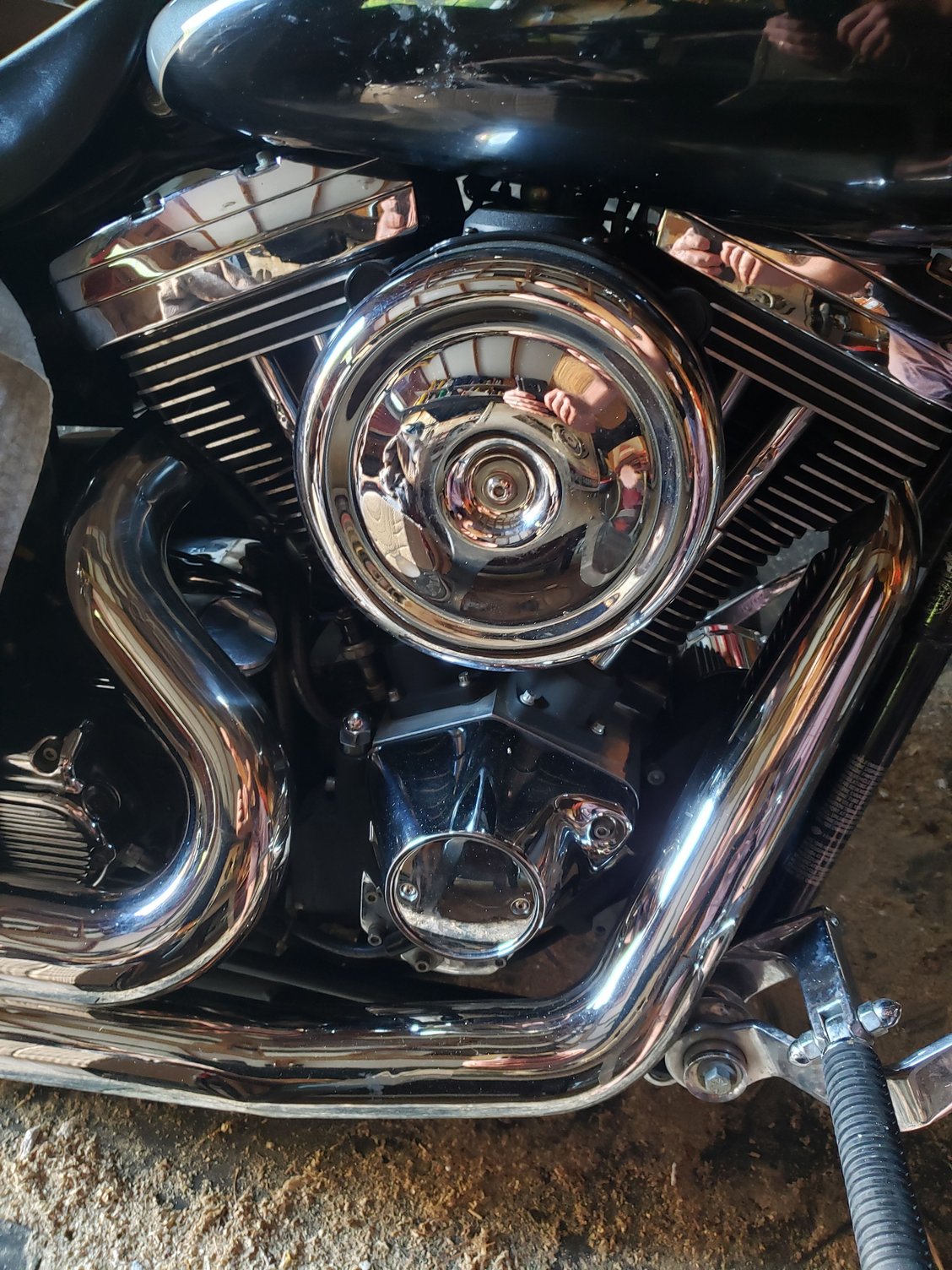

96 fxdwg, non numbers matching with only 9 digits. Anybody have any ideas? I'm stumped
Serial number is: BS3682663
Sorry about the crappy pictures, the shift linkage is in the way

Looks like an aftermarket case to me. Can you post a few more photos please, showing both sides of the engine?
Also, this bike is supposed to have a 3 bolt derby cover and it has a 5 bolt....

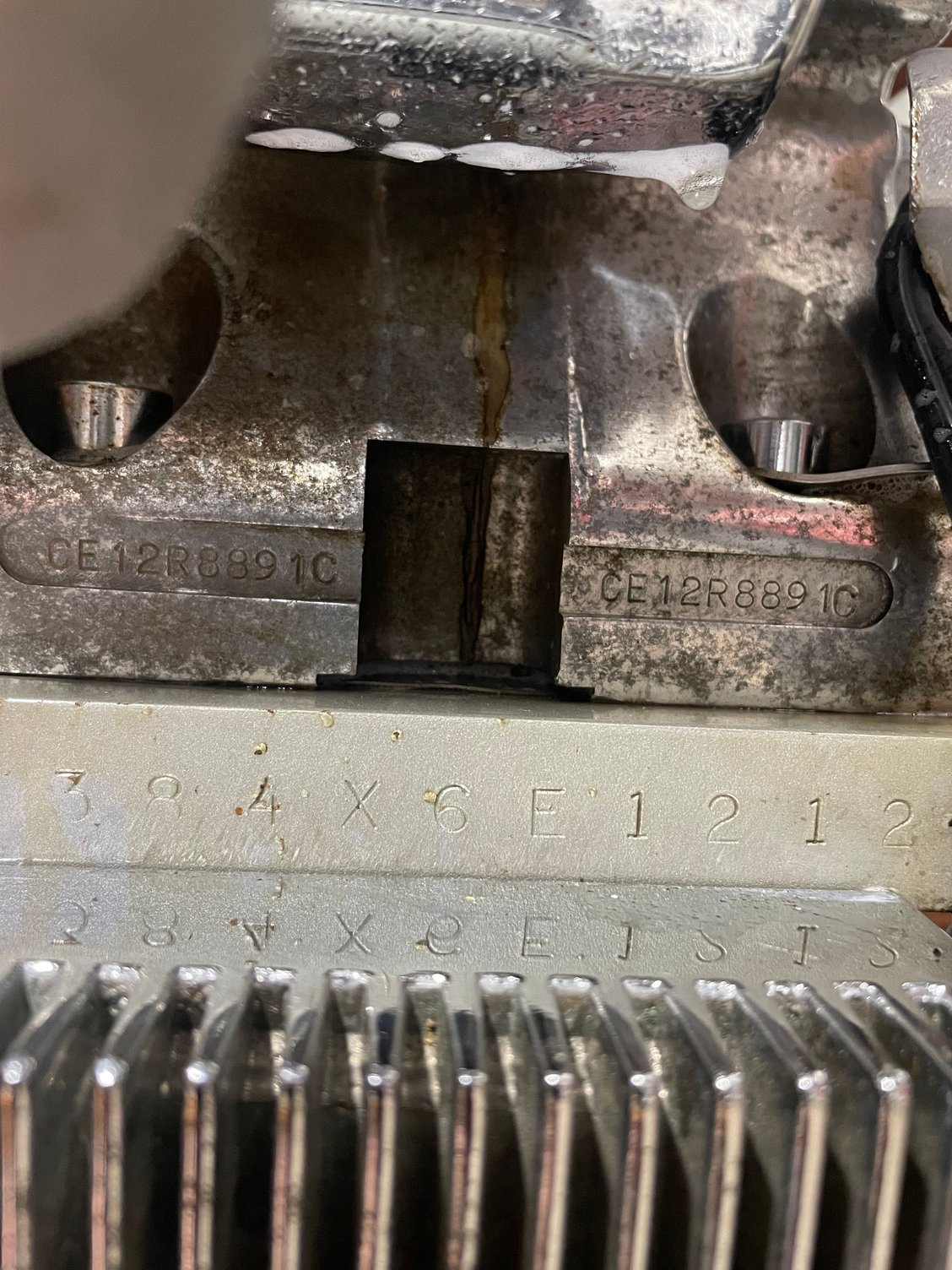

if your engine number is not in the same format as in whs's reply, your engine may also be custom, in which case post some photos so we can take a close look at it (the engine, not the bike, although we would like that too!)
cfmk118841*

Originally Posted by Clifford flynn
cfmk118841*
1989 XLH 883 Deluxe.

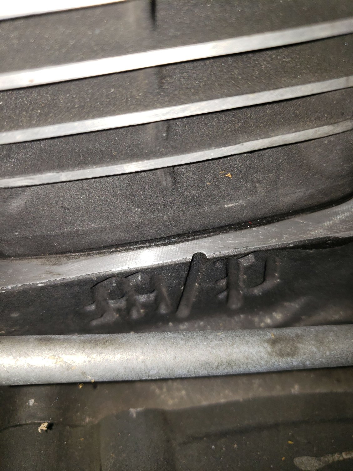

Default Here is one VIN I can’t find anything on, and help be appreciated. Thanks
If your engine number is not in the same format as in WHS's reply, your engine may also be custom, in which case post some photos so we can take a close look at it (the engine, not the bike, although we would like that too!)

It’s an Midwest Ultima EL Bruto 2012 4” bore.. probably a 113

Correct for a 1976 XLH, 3A =XLH (4A=XLCH) and H6 = 1976...simple **** back then!!
And...Drum rear brake until After 1978!!
As an aside...tho Ironheads have their own Sound...especially with Drag Pipes (being an Iron Motor) Mine always ran best with fairly free flowing Mufflers....Always..
