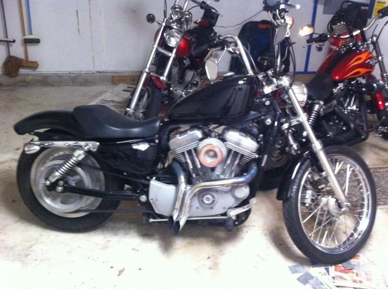

So I wanted to post some pretty kick *** updates to the scoot. I recently deployed and asked my buddy Austin (Agove from the above post) if he could babysit my Sportster for me. He asked me a bunch of random questions about what I wanted to do with it when I got back. I told him I wanted to paint it, chop the frame and turn it into a bobber. This is what it looked like when I got back:
He apparently decided to pull the tins off and paint them all for me. I also had a pretty wicked dent in the right front side of the tank that he filled and smoothed out.
This week he decided to chop the rear fender after I told him thats what I wanted to do to it.
Then chopped the frame
So I picked up a Mother Road Customs solo seat and a mounting kit. As well as some rigid struts and he threw it all on for me. This is how it sits right now.
Next think is a wire tuck and probably a tank lift along with and ignition relocation. Then black out some of the engine parts and get rid of some of the chrome.
