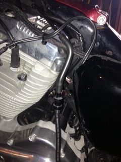

I was installing my battery in a 2009 Sportster when I noticed this line hanging down from the fuel tank. I've been looking for an attachment point but haven't been able to find it.

Also is it safe to start the bike with that hose hanging like that?

It's the vent hose. It's supposed to vent to the atmosphere. Just clip it back in place and tuck the hose out of site.

The clip is to the left of the battery. The black plastic piece on the hose (vent valve) fits into the clip just to the left of the battery. Then just tuck the hose away to vent to the ground and replace the battery cover

So it just vents the fuel tank?

Si.
Yep that's it
