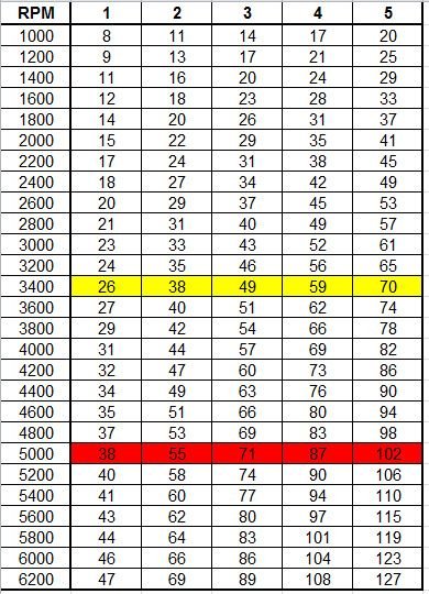

Manual's not right. Their shift points are way too early.
Here's a chart that should help. The yellow is about where I ride.
Yup..the yellow is where I mainly ride. My shift points though vary depending on situation, but I don't shift to 5th until 70 mph usually
(depends on traffic).
A lot of new Sportster riders seem to shift way to low in the RPM range. I know what the manual says, but those are "recommended" and it notes that shift points vary depending on rider style.
When new Sportster riders go by "sound" they are almost always shifting way too early based on posts in the forums. As you know, if you are not riding in the yellow band (or higher), you are not taking advantage of the "Sport" in "Sportster". Might as well get a big twin than a "Sport"ster in my opinion.
Too me, if you are shifting into 5th gear at 50mph you need to try riding at a higher RPM to see what a Sportster can really do. Ride in the Yellow Band above. Give it a try, if you don't like it, go back to your style of riding.
Heck...my bike (1200cc) is absolutely smooth like glass at 60 mph in 4th.
At 70 mph it is smooth as glass again in 5th. I have found that also at 85 mph in 5th, I hit another smooth spot (3rd gear smooth spot is 50 mph).
