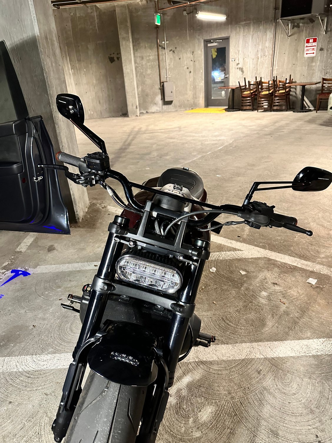

Just installed the Tracker Handlebars. Easy install , some things didn’t fit perfect and my grips feel a lil bit loose . Haven’t taken for ride yet planning tomorrow.
any suggestions on the grips ?

Hair spray on the grips will hold them in place, and it wont ruin them if you need to remove them at some point.
Spray some inside of the grips and slide them on. Let them dry for 24 hours and good to go.

The grips aren't glued on with the Sportster S/Pan America/Nightster. The left side is held on with a clamp and the right side is captured by the switchgear housing.

You should be good on the throttle side. Clutch side add some tape under where it clamps. Bar looks great!

Going to take back apart tomorrow, got some grip tape also like the hair spray idea. Throttle side Dosent really move only clutch side . I looked for a click in spot like the old bars but didn’t see anything.
good points thanks !
