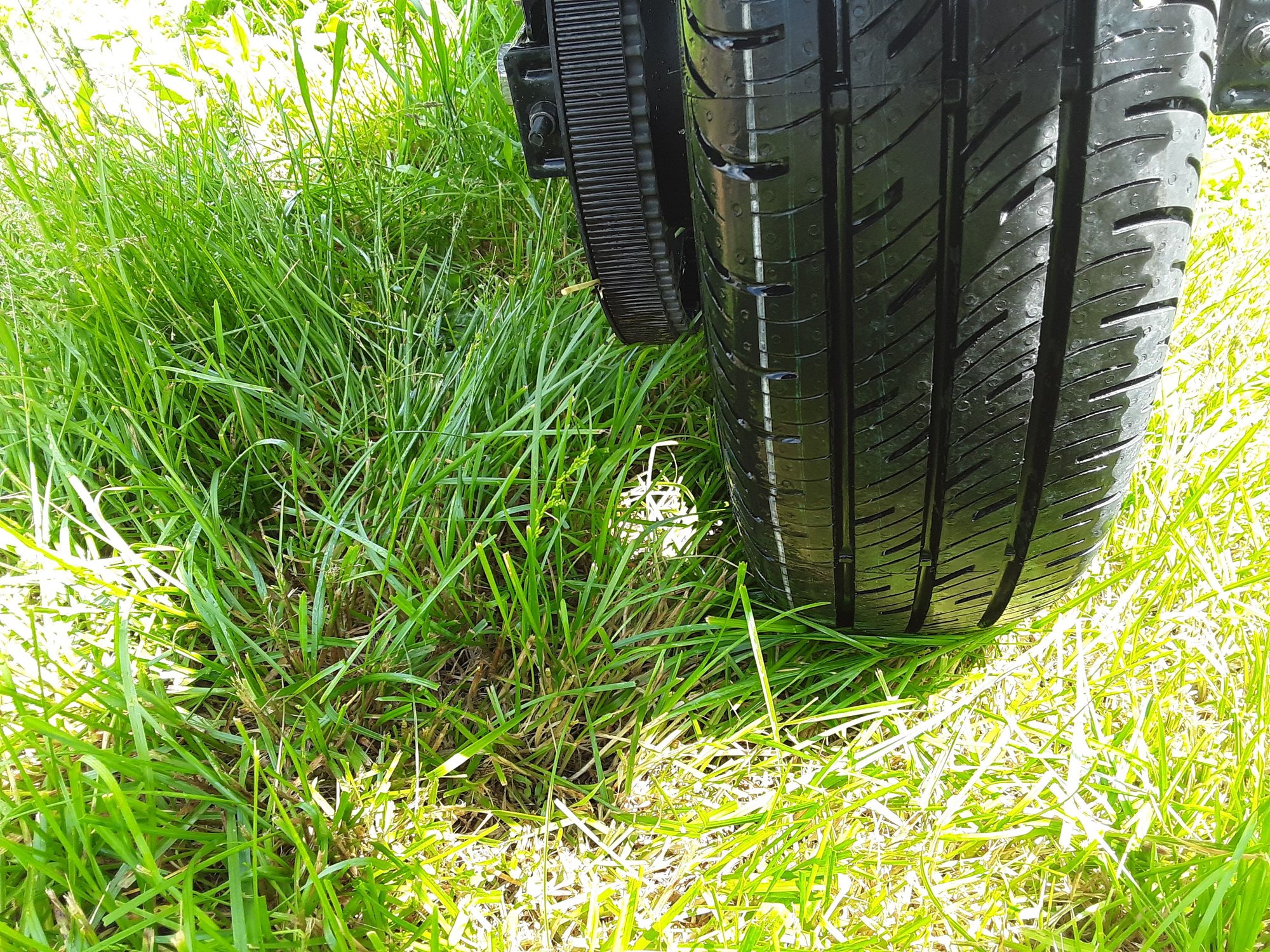

On a HD Street 750 I am running a Smart Car tire. Granted it is for a Sidecar rig . I did take the sidecar off and run the bike with the car tire for a while. I was surprised at how well it did. I run the same car tire on the sidecar.
155/60 R15. I also run a Car tire on the rear of my RGU rig that works very well. Bead is not an issue on either one of them.

I know some will tell you that you can not put a 15 inch car tire on a 15 inch motorcycle wheel. There may be cases where that is true . But this is the 155/60R15 and it works fine.

I am not going to argue that car tires are better on a two wheeled bike than a good motorcycle tire . I can only relate my experience. Running two sidecar rigs with out car tires I would go broke buying tires, When I went with a car tire on the HD 750 with a sidecar I was told it could not be done due to the 15 inch wheel. That was soon proven wrong. At the time I mount the tire the sidecar was off . Working on it. I decided to take it for a ride with the car tire and no sidecar on it. With motorcycle tire every time I got on the bike hard from a roll or stop rather than the front end coming up the back tire would spin. With a car tire it did not spin. The bike handled fine, of course I did not enter it in a road race course. I really wanted to know it it would hold a bead. I had a spare wheel so I mounted a used car tire on it and hug it on the wall. To this day it still is holding a bead. After putting the sidecar frame back on the bike I beat the heck out of . Flying the car , hard cornering it it was going to fail it would have, it did not. few videos of it. Latter changing the sidecar on that one to a car tire took some work ,changing axle cutting down a stock Street wheel But it work well. The sidecar now runs the same Car tire the bike does. And it works far better than I expected. So well we converted a friends to the same setup.
On the RGU a much heavier and larger rig. Going to the Car tire on the bike was the best thing I could have done. The sidecar already ran a 13 inch car tire that worked well. I know many that go to a car tire in the new frame HD use a different size but I went with 195/60R16.
The reasons were simple heights is the same as the stock tire. It gave a little more clearance (about 1/2inch) than the 205/55R16 that others seem to use. I took this rig on the dragon last May. Pushed it hard loaded and with someone in the sidecar. Far more stress than you will ever put on a two wheeled bike. never an issue with the bead holding.
On the RGU rig I have replaced the rear sprocket and belt a lot earlier than I would have on two wheels. The cause was not likely the car tire but winter riding it spent a lot of time in salt and winter road condition.
