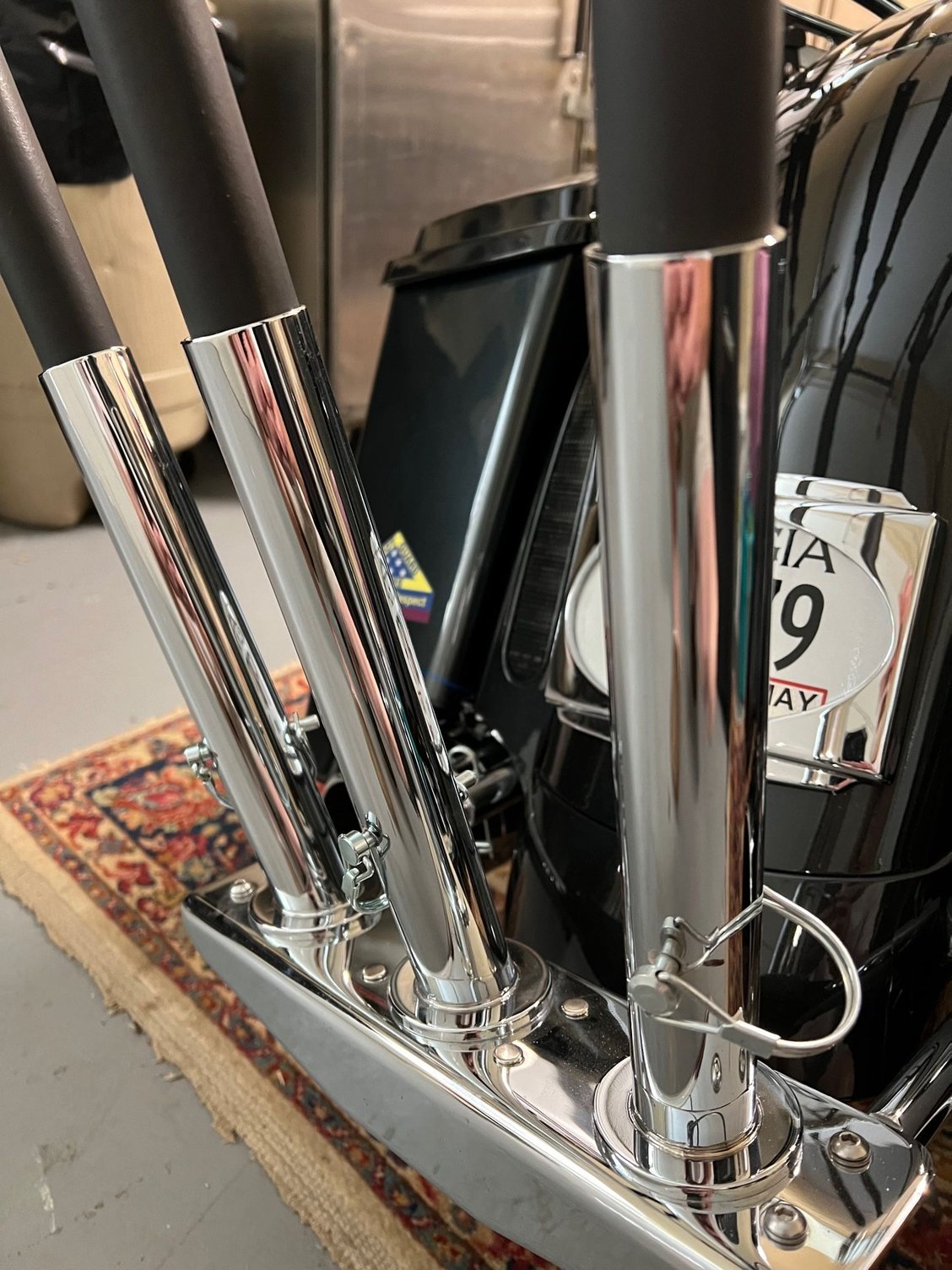

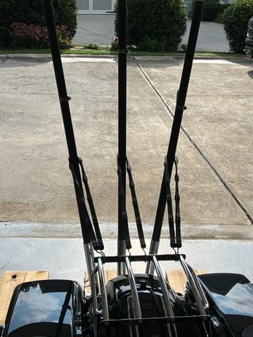

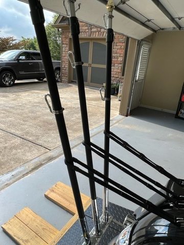

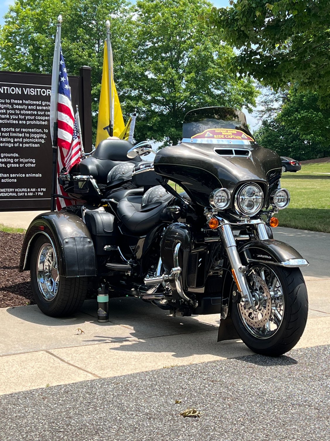

I have the Rivco setup on my Road King but I used fiberglass extendable paint roller polls. They are very strong unlike the Rivco polls, yes they are the same size so they fit in the hitch tubes. Then I used a 36" bungee cord to wrap around the pole and hooked it to my luggage rack or backrest. This will keep them from wobbling so much at high speeds and transfers the movement to the bike so it will take a few times to get used to riding this way (for those who haven't experienced it yet). A little jerky at speeds. I did the same poll set up on my trike but with three wheels you don't feel the wobbling.
I painted the polls with a high temp "ceramic" paint. It dries very quickly and will hold up much better than enamel sprays.

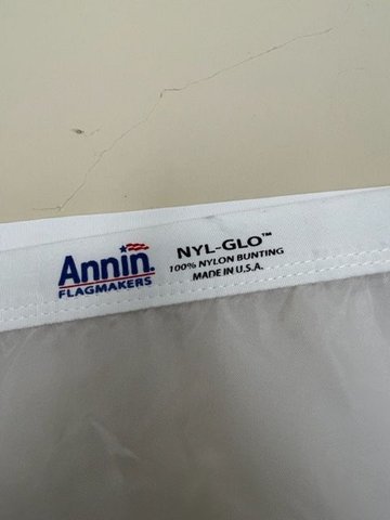

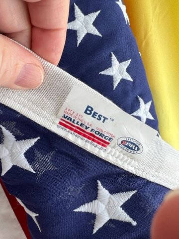

Flags... I order my cotton USA flags from Valley Forge and triple stitch the trailing end (although they are tough flags) just to give it an extra advantage. Flags are expensive so buy yourself a sewing machine and learn how to use it. My Singer has saved dozens of flags especially the thin service flags. The best thin service flags I've seen and use comes from Annin. Their grommets hold up very well but like all thin flags you need to triple stitch the trailing ends. Oh, buy yourself a good grommet kit and put a center grommet in your favorite flags. This way you have three points of attachment. The tighter you make your flag to the poll the longer they will last.
Anything over 60 MPH will of course kill flags no matter what you do. Once in Georgia, the Highway Patrol decided to get up to 100 MPH during a cross state escort late one night. The bikes held up just fine but the flags were ripped to shreds as you can imagine. From time to time when my service flags becomes so distressed I will fold it and present it to the family after a service so never get rid of old service flags. Fold them and prepare to gift them to the family. You may be surprised at their reaction of total joy knowing they have a part of the Rolling Honor Guard.
Anyway... here are some pictures.

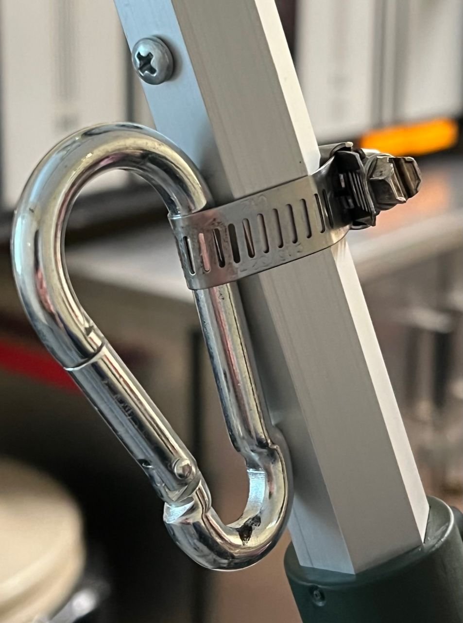

Do you use those ss rings as a secondary device to hold the flag grommet to the poll? What are you using as the primary? Can you take a picture of yours for us?
This is what I'm using. One on top and one on the bottom. I use a center when hwy speeds are needed. I keep a 5/16th nut driver to adjust the clamp to the flag length since they run different sizes. It's a little bit of work but the flags last longer this way.

Almost identical to yours! I have 2 hose clamps on each caribiner, 1 at top, one at bottom. Yes, the stainless hoop is a secondary, just a safety strap if you will, around the pole and thru the flags gromet. I'm kinda paranoid about them flying off and blinding the rider behind me.

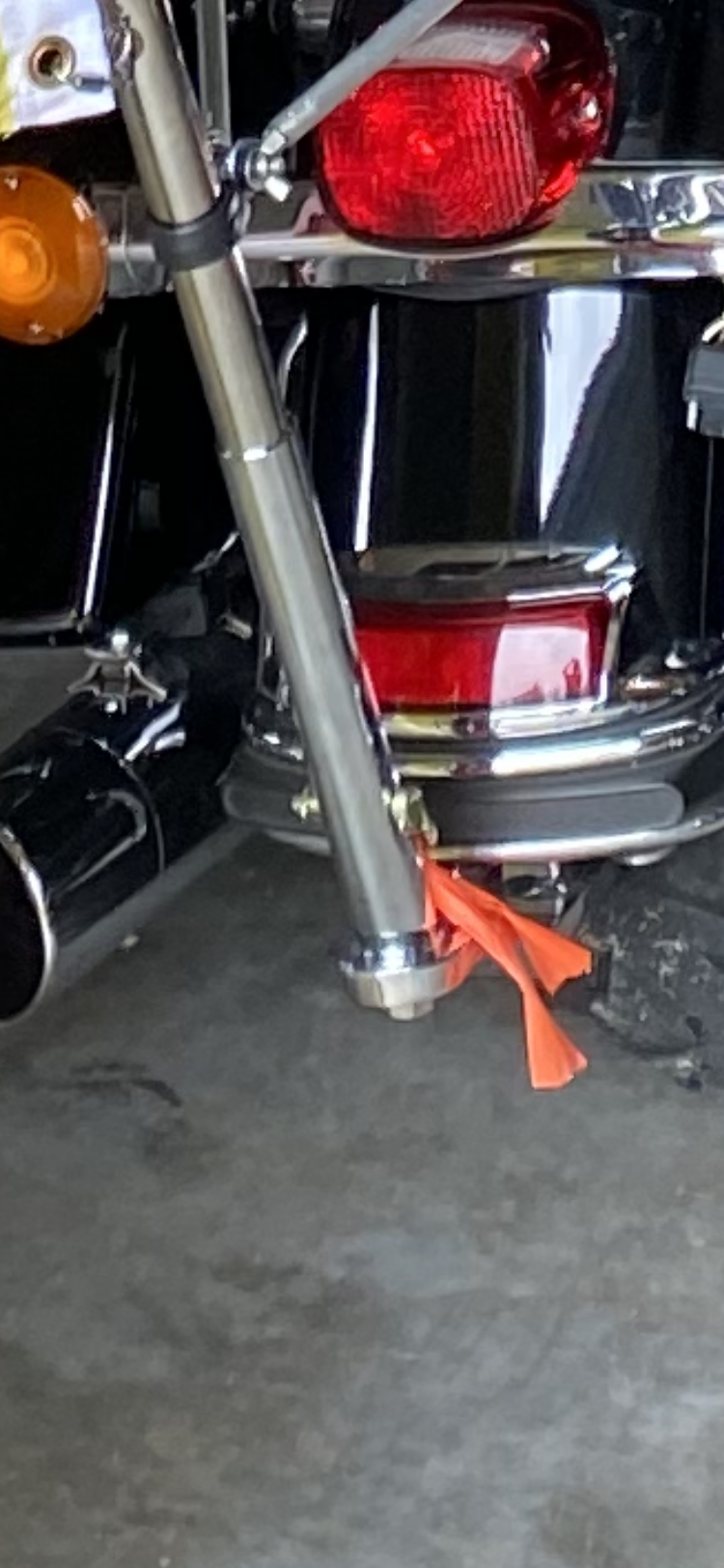

As far as how I retain my poles... Here is a picture. I don't think an ambulance chaser has a chance in proving negligence.
