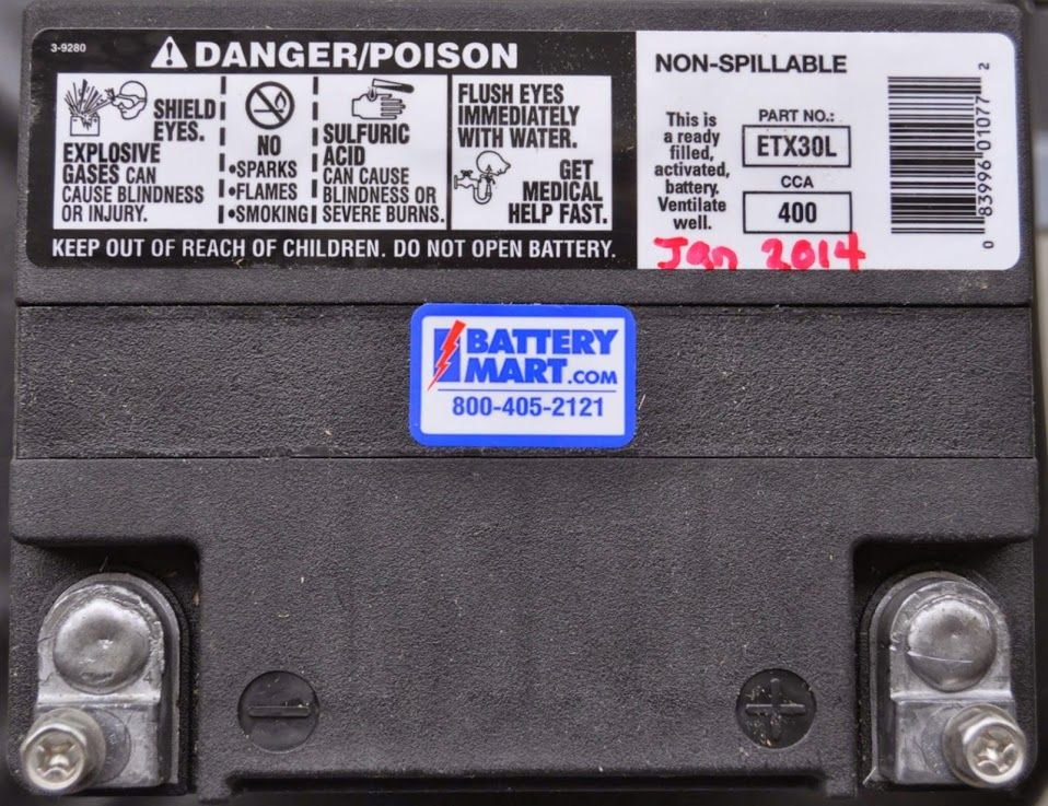

Screw the high-priced HD battery. Here's your battery:
$100 delivered. Do it and start riding again. And keep the tender on it when not riding.
I agree. I got a Big Crank AGM battery from BatteryMart.com for my old bike a few years ago for about $89. Delivery included. What they don't tell you is it's a Deka battery rebranded.
