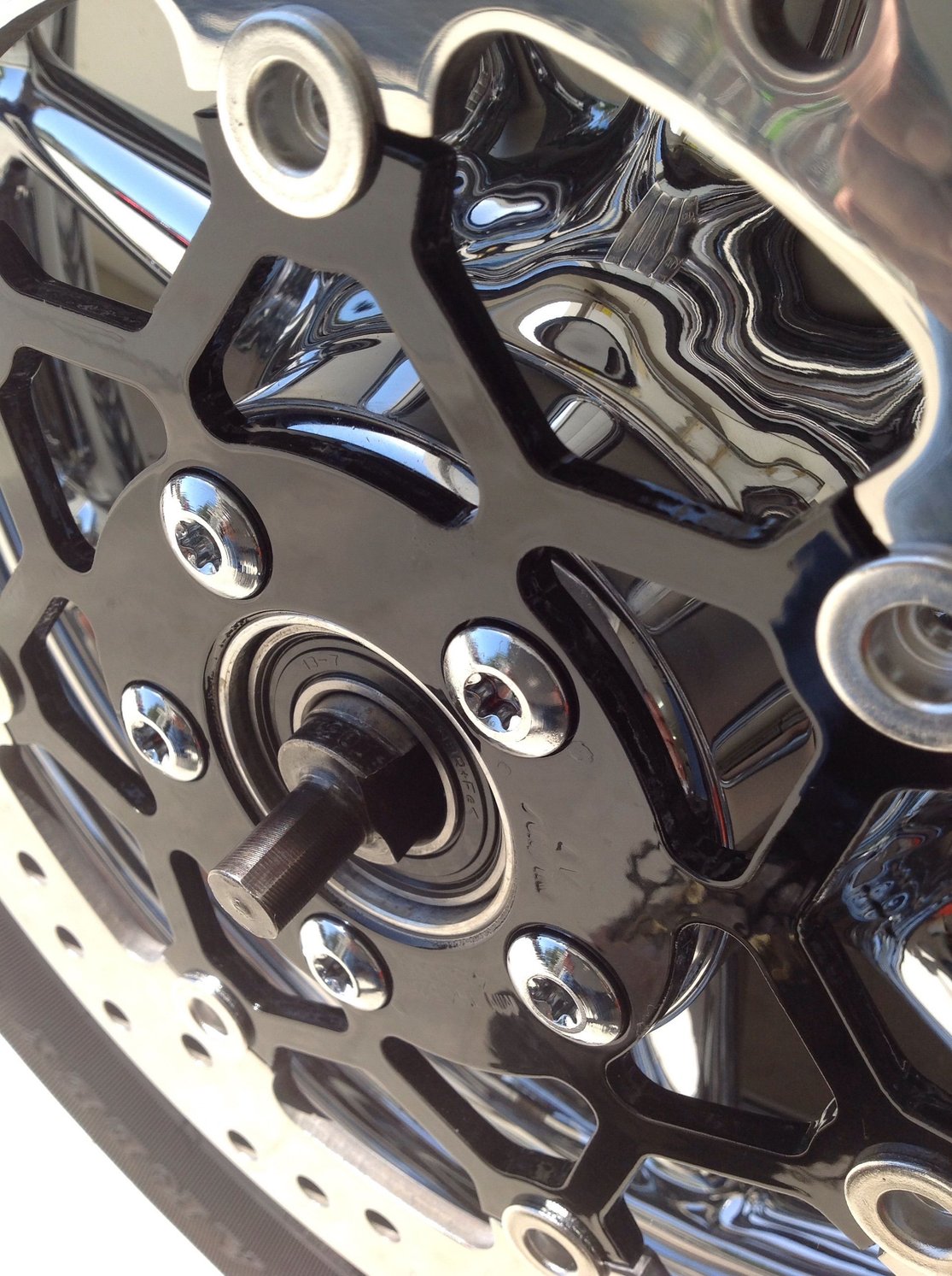

The 1" step bit picture doesn't quite fit in the 1" bearing so I think it might just be the right size for the caliper.... Hmmm? Mayby the step drill would track fairly straight... I've done stupider stuff in the past...
