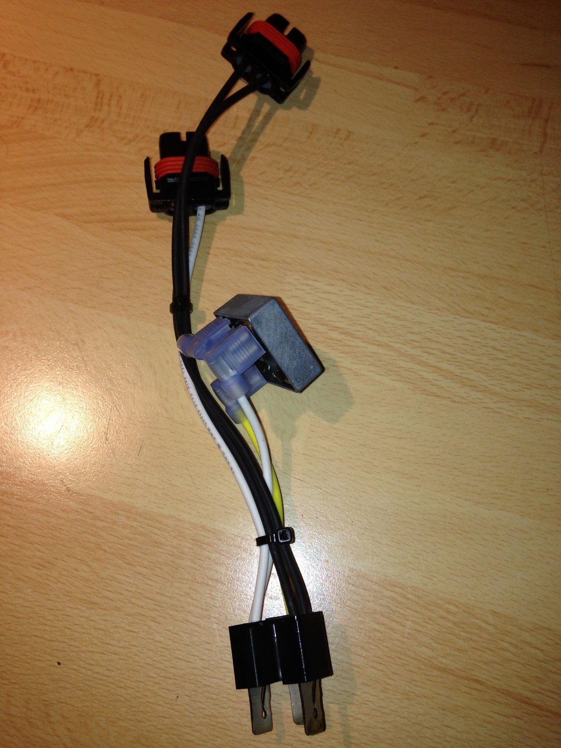

Old Nov 25, 2015 | 08:16 PM
Fxdbi-06's Avatar
Fxdbi-06
Joined: Nov 2015
Posts: 36
Likes: 41
From: Wasaga
Default Dual bulb harness
Try HD pn-#70319-04
If you have the 3 pin socket type. Works for hid/led kits.
$30 tops. Harness has a splitting diode.
Your welcome.
No pic on google of this harness, but this is pn-70319-04
Old Nov 25, 2015 | 08:26 PM
Fxdbi-06's Avatar
Fxdbi-06
Joined: Nov 2015
Posts: 36
Likes: 41
From: Wasaga
Try HD pn-#70319-04
If you are running dual hid/led.
Hid is superior to led. Super bright. But the led PROJECTOR headlights do a great job as well. Not so sure led bulbs in a regular halogen housing is good though. You wont get the same affect as if it were in a projector lens.
For dual bulb HD headlights. Go with HID - low, LED -hi. The led response is less than 1 sec. Hid takes about 5 to glow fully.
