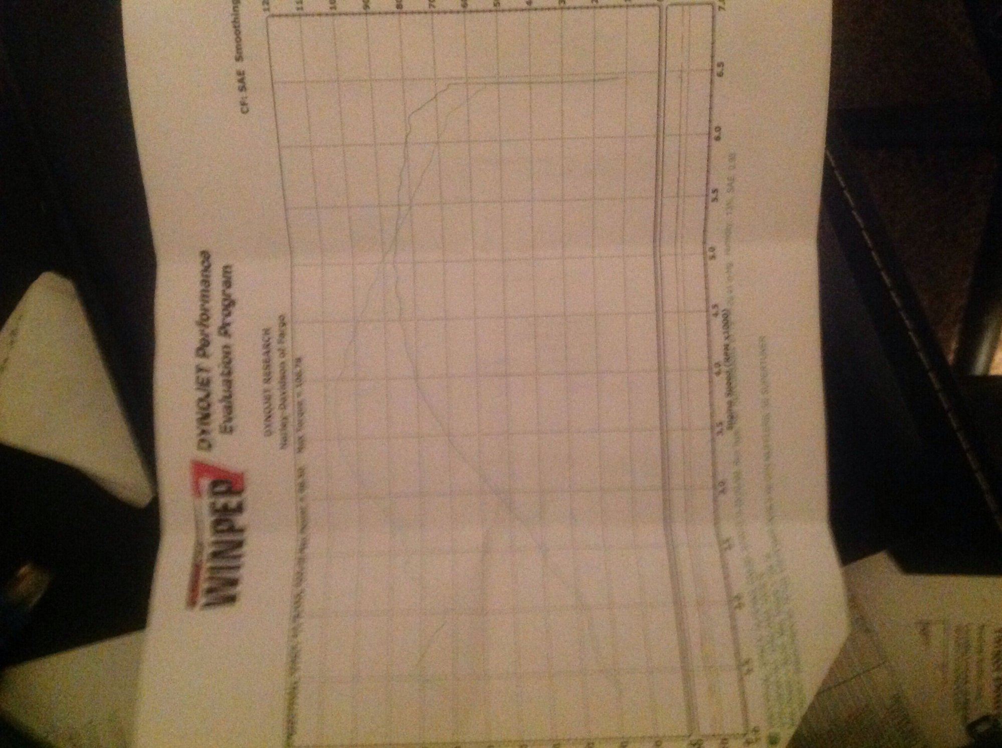

I have the same setup, except CFR mufflers 86.5 hp 106.78 tq

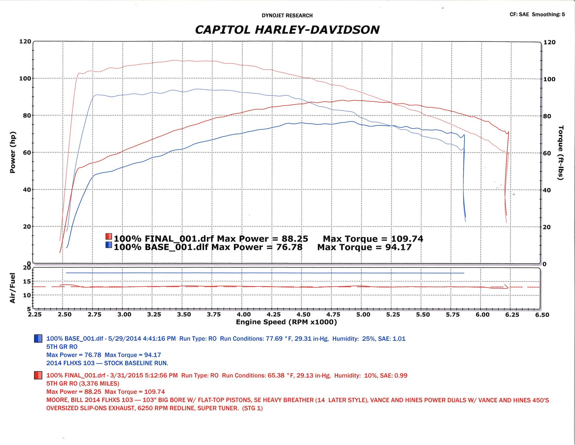

Here's the dyno sheet (went away for the weekend and forgot to post it).
I'm not sure why some people aren't believing the numbers (I said 109 TQ, but it's actually 109.74). They're very similar to what FuelMoto got in tests of similar setups.
I know some people were curious about the sound. It's exactly what I was looking for. I didn't want obnoxiously loud, but i wanted something with a deep idle (like an old big block) that made you stand up and take notice when you punched the throttle. This fits the bill perfectly and I'm very happy with it. When you get up to speed, it's a noticeable increase over stock, but it's not annoyingly loud, nor does it hit that weird drone pitch that irritates the hell out of you (I've had that on a few bikes and vehicles in the past). BTW, I went back and forth between this and the D&D FatCat and I made the right decision for me... although you may like the louder and higher-pitched D&D.
And, as with all V&H products I've used, the fit and finish are perfect. I didn't realize what a difference 4.5" vs. 4" would make under the saddlebags. They look tough and have a sound to match.
Bottom line: I'm very happy!!

Great looking graph there Bald! Very nice smooth lines, you should enjoy that for a while.
