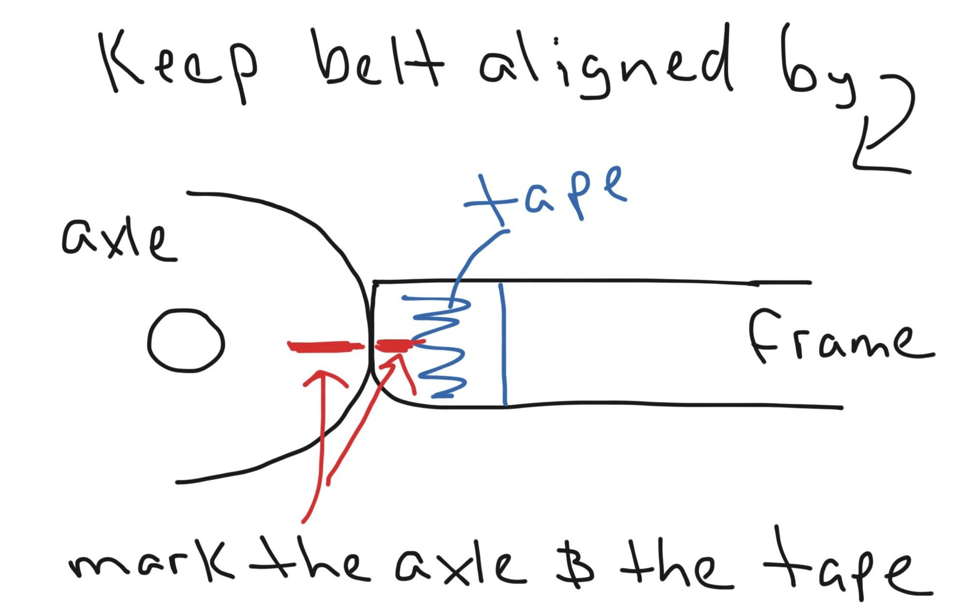

Put masking tape on the frame by the axle, using a permanent black marker mark the axle adjustment so when you reinstall you only need to line up your reference marks (see my 3rd grade photo below)
My info is for a 2012 Ultra

what year/model bike? as I do not have to remove shock bolts as some are suggesting.
I'd guess the year and model will yield the specific info you're wanting.
No clue how you'd do this without a lift....none. Pull bags, slip ons- good time to inspect/clean them really well.
Have antiseize on hand to smear on axle....
Good time to check/replace rear pads.
make sure you have sockets/wrenches big enough to pull axle. Watch the balance of the bike on the lift once you pull the rear tire!
Time to check Rear Wheel Compensator Isolator (rubber thing)
This is an old thread that got revived but the mark on the adjusters is a great idea but I put it right on the adjusters so that with a glance I can see if it's still in place. ......Like the time my dealer had a special on tires with FREE install. Got home and looked at the adjuster and it was off by several cm and the belt was too loose per manual specs!!!

ugh, yea, I have to look at the post dates in the future!
scary yours would be that far off esp after being at the dealer, that's why its worth checking thats for sure.
Good tip and I do put reference marks on before I remove the back wheel, but this would be a good time to have a belt tension gauge to check the belt and adjust it if necessary.
