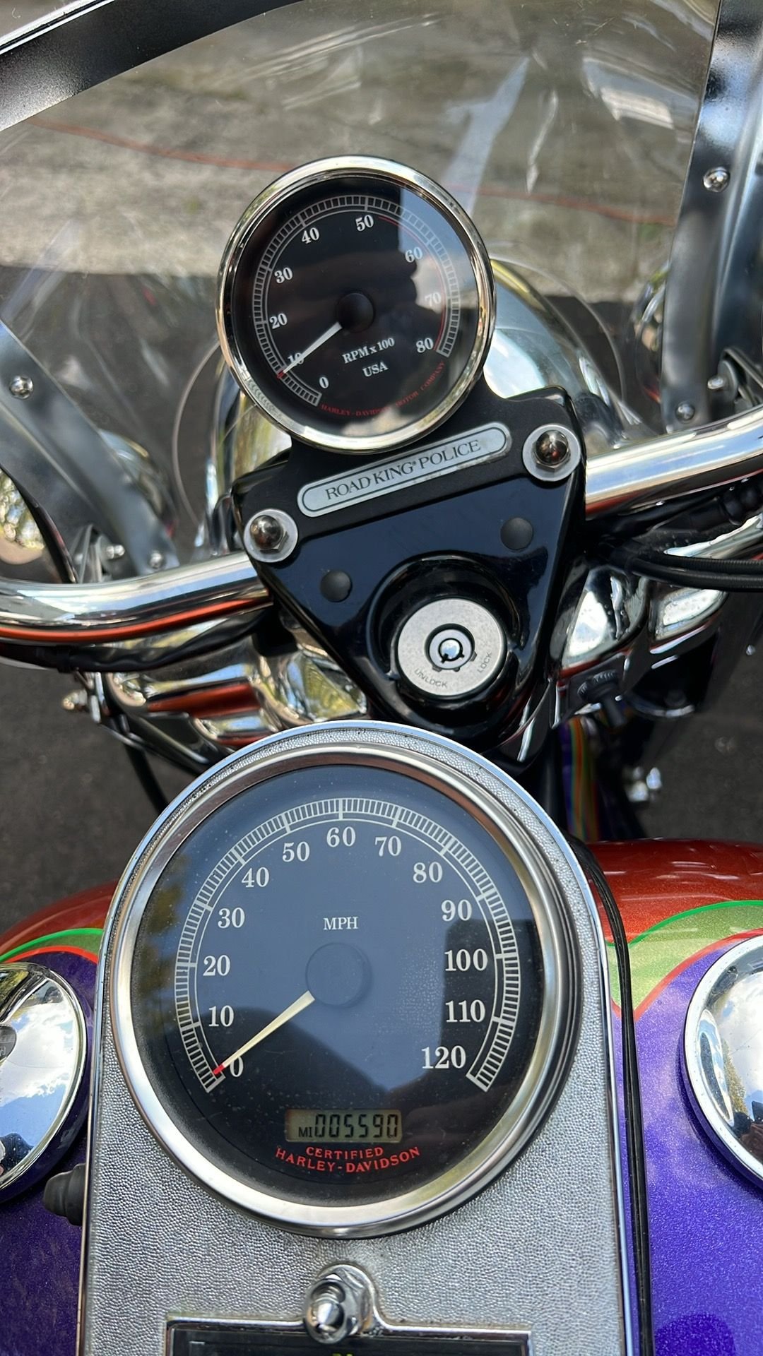

I added my police roadking tach to my 06. Get a 3 wire tachometer + and - and Pink. Find +and - accessory hook up in headlight housing. Once you mount tack to handle bar mount find the pink no3 wire at ECM. Make a small cut to expose wire and hook up your wire from headlight housing. And you’re done. I tried what others say but there is no pink wire under speedometer or in headlight housing. Hope this helps believe me this works Thanks damondent89@yahoo.com
