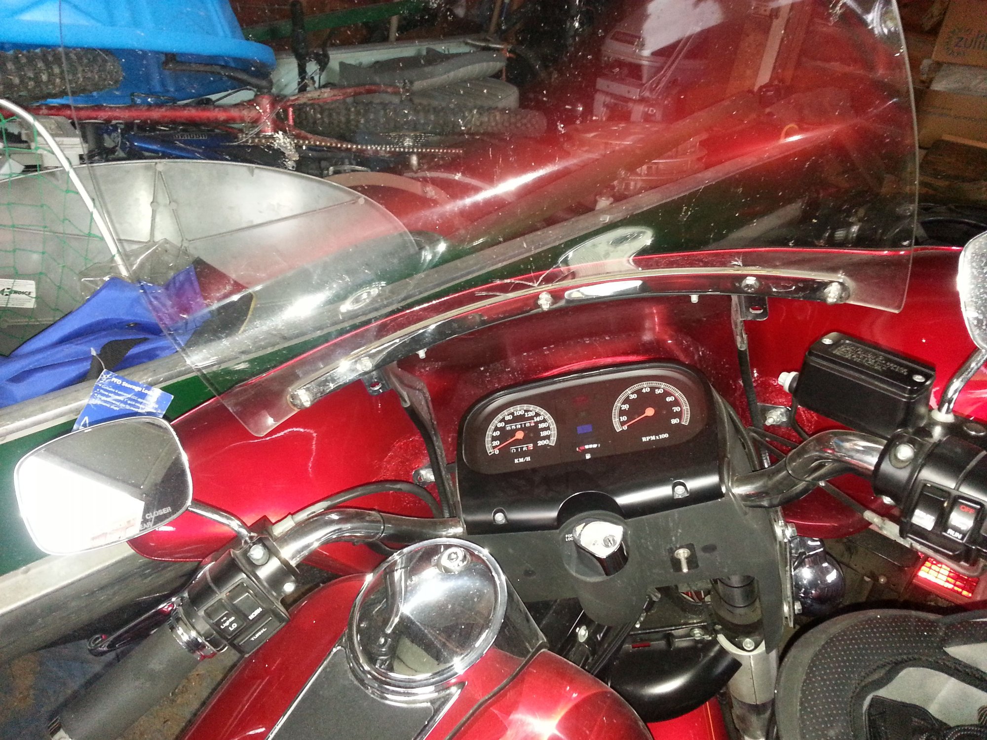

If you didn't buy the bike new it is possible you have the H-D FLHS batwing kit, which is essentially a glass-fibre shovel batwing with dedicated FLHS brackets. If so you probably need a late shovel windshield, which has 5 holes along the straight bottom edge. Cee Baileys sell them. This is my '83 shovel fairing on my 1990 FLHS, with home-made brackets, showing the chrome windshield mounting strip:
Attached Thumbnails Fairing 'Windshield' for '92 FLHS Electra Glide-tomtom-final-2_e.jpg

Thanks grbrown, that looks like mine... I finally got around to posting a pic... here it is...

I should add... my father bought the bike new back in '92. He purchased all the add on accessories at the same time.

I've only ever seen one of those kits in the flesh, which were darned expensive to buy new IMHO! Your mounting brackets are neater than my home-made efforts, as one might expect.
