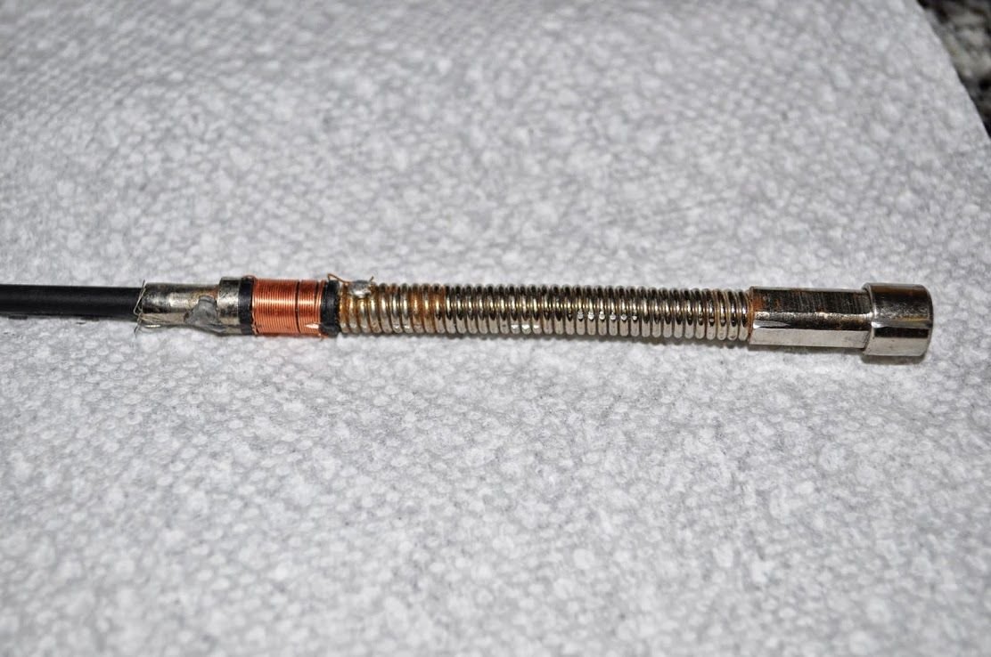

The chicken band radios on our touring bikes output about 2 to 2.5 watts into a 50 ohm load. The feedline and antenna presents a very inefficient load to the transmitter, reducing usable range. But it will work at short distances. The ground issue is important for the shitty antenna to do it's pitiful thing. Would be nice if you had an rf power meter you could put in line and see what's what. That would tell the story. I bet it's ok, just adjust your squelch to a threshold just above the noise. Then ensure that your buddy has his radio on the same channel and that his squelch is not turned up too much or he won't hear you no matter how close you are.
Here's what the antenna coil looks like inside. There is a little hair-sized wire that connects the coil to the whip and another that connects the coil to the spring base. If the antenna is flexed too much, one or both of these little wires break and the shitty antenna is now worthless. You can see a picture below of what's under the plastic cover on the base of the cb antenna. I now use a Hustler antenna and it's much better.
