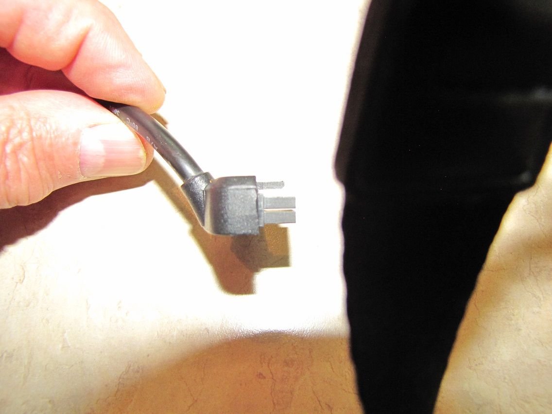

I hope you saw the post by Skratch, I said 12mm O2 sensors and they are 18mm. They went to 12mm in 2010 I believe and moved them down next to the transmission.
The PV2 just clips into the holder so you would remove it from the holder, turn it over and press the release on the plug in and pull back. I took a picture of the unit and cable and put a little yellow paint on where you push down to release it. I bought mine used and it came with the cable attached, it took me a while to catch on how it worked.
Good Luck
