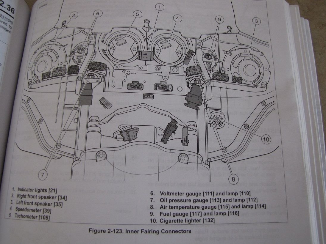

clear a spot to put the outer fairing once removed, place tube socks over the spot lights, thick towel over the fender
remove the windscreen screws and windscreen...replace the CENTER screw loosely
remove the 2 inner fairing screws -torx, there are 2 more down low as well- ( see service manual pic in post below)
the outer fairing is now only held by the CENTER screw which you put back in....straddle the fender and work the fairing to break the "seal" of the gasket... then lift the fairing towards you over the spotlights.
reach in and unplug the headlight...and put the fairing aside
mike
