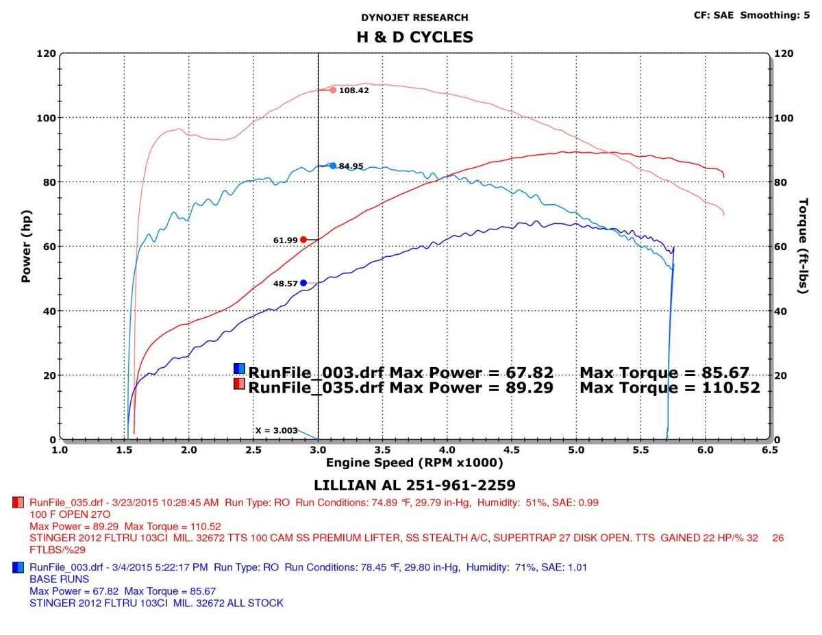

In fact most dyno charts dont even begin to register until about 2200.
Scroll down to the bottom of the page to see what I mean.
http://www.fuelmotousa.com/p-28617-1...-bore-kit.html

Take a look at these cams.
I've ridden them fairly extensively, 115tq 92hp, I do like them in a true bolt in application.
