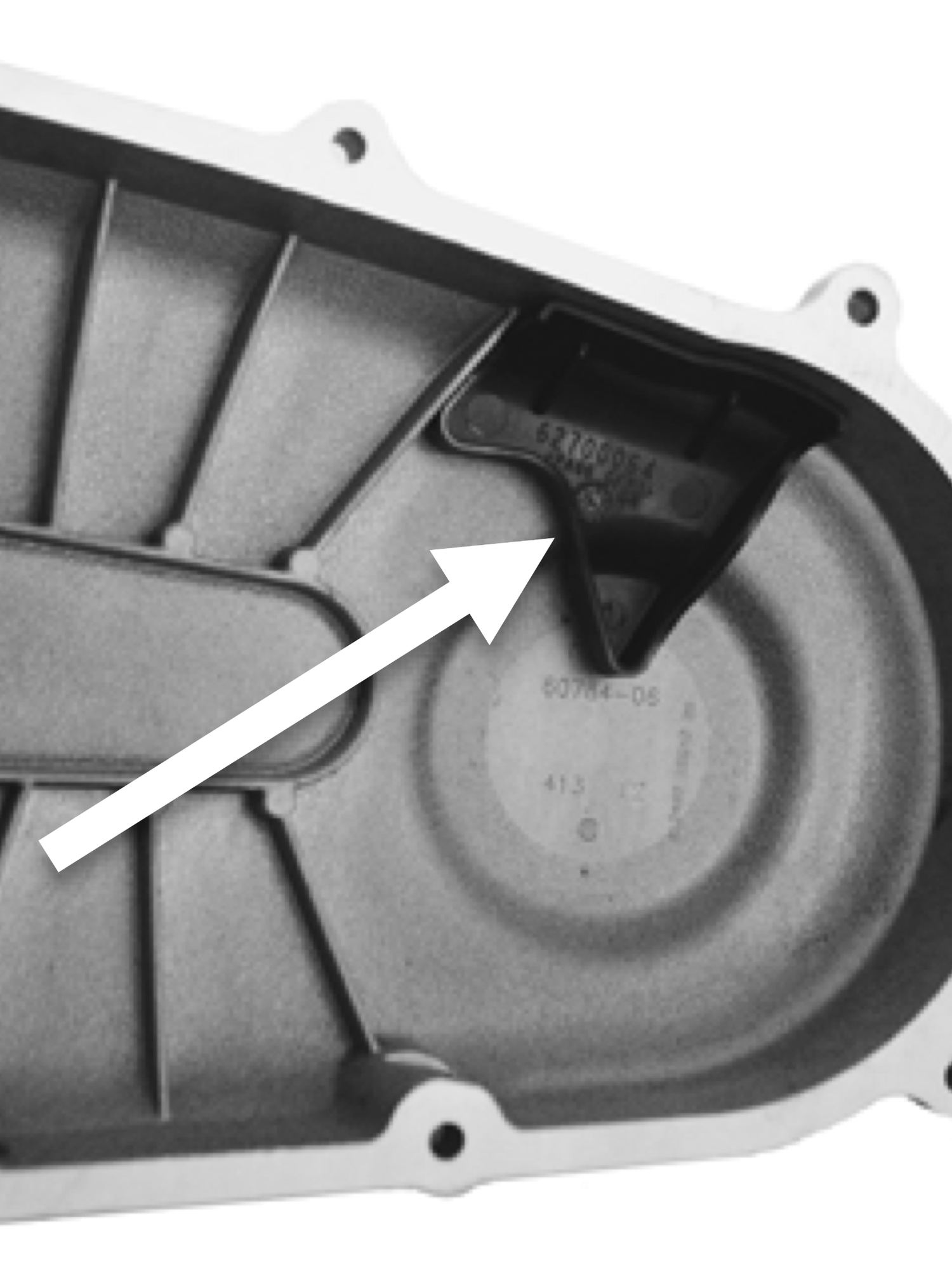

Originally Posted by Gwaxley
There's an oil deflector in the case that is suposto help oil the comp and bearings. But if your a comp eater then your a comp eater, I think it's how you ride. If you decel and excell hard consistently the cam lobes rotate to there fullest in both directions. After a while the lobes and the lobes and where they contact the sprocket wears and allows even more movement in both directions and the wave springs can't compensate that mush movement? That's my theory how ever dumb it may sound to some.
The easer you ride and do not engine brake and geardown hard the longer the comp will stay health. Please jump on my comp eater theory like a pack of banshees!
You bring up good points!
Is that deflector on your primary cover?
That deflector is NOT on my stock primary cover. There are aftermarket deflectors to help bathe the comp in oil though.
The Rushmore (I think) has the SE comp, it should work good with Harley Formula+ oil filled up to the clutch plates,,,,,,,,,But, since the bike is probably not completely upright when filling, going past that point is probably ok and good for oiling the comp. This next oil change I'm going to make a point of using enough oil.
Riding habits might be a problem with the comp galling, I baby my bike but don't ride like a grandpa so I hope it holds up.

The '14 and up primary covers have the deflector cast into the webbing. That photo is a softail"B" cover, The touring "A" covers deflector is in a different spot on the bottom edge. The plastic glue in deflectors that have to be used with 09 up SE comps come with both in the kit. Took me all day trying to figger out where the other one went lol.
The plastic oil deflectors have tobe glued into the the primary cover, special glue, not sure of all year models my 14 has it. There's some grinding involved to install it also. I'm sure it's a diy job with a little research on YouTube.

Here's a picture of my stock cover, looks like the casting has a deflector.
I have the narrow cover on my bike now.
